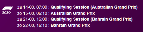

Rob67ert wrote: Friday 17 January 2020 16:46 Is there a way to only show the start time of a calendar event?
I don't think it is an option right now.
But I also would like that, especially for the F1 calendar.
I worked around it by changing the calender.js file (I have only 1 calendar)
Change the line almost at the bottom of calendar.js:
Change:
	var widget = '<div style="color:' + item1['color'] + '">' + item1['startdate'] + "" + item1['enddate'] + ' - <b>' + item1['title'] + '</b></div>';
to:
	var widget = '<div style="color:' + item1['color'] + '">' + item1['startdate'] + "" + ' : <b>' + item1['title'] + '</b></div>';
Of course, you need to do this again after every update.
Maybe it is possible to do a feature request for this.

toro wrote: Thursday 06 February 2020 0:38
Change:
to:
Merged into beta.
set the 'startonly' block parameter to display the start time only.
toro
Posts: 50
Joined: Wednesday 09 August 2017 23:05
Re: Dashticz - Module - Calendar
Post by toro »
Lokonli, this is great!
I did update the beta and added startonly:1 to the calendar line in config.js.
It works like a charm. There is now way I could fix this myself, so thank you very much.
A very usefull addition to the calendar

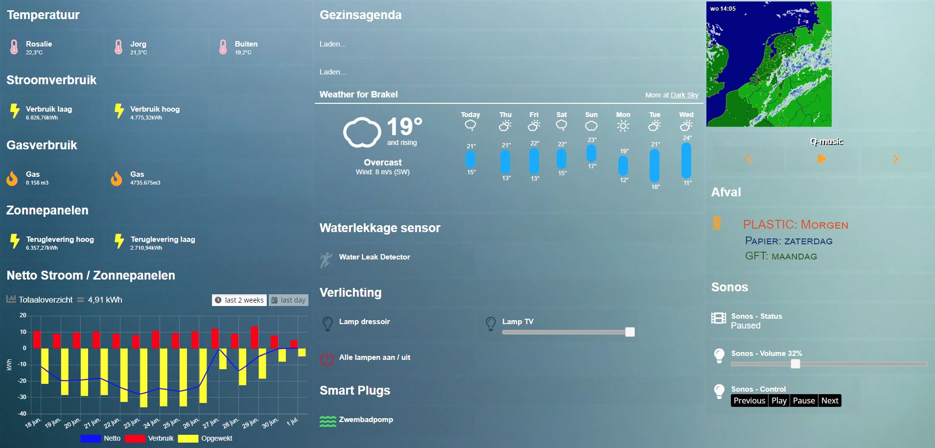

Even though I tried all kind of solutions I still can't seem to get my Google calendar in my dashboard. It just says "Laden..." (Loading... for non-Dutch people). Here is my config.js script. Maybe not the most decent one but it works (except for the calendar):
var config = {}
config['language'] = 'nl_NL';
config['domoticz_ip'] = 'http://192.168.178.24:8085';
config['app_title'] = 'xxx';
config['default_news_url'] = 'https://cors-anywhere.herokuapp.com/http://www.nu.nl/rss';
config['news_scroll_after'] = '4';
config['timeformat'] = 'DD-MM-YY HH:mm';
config['calendarurl'] = 'https://calendar.google.com/calendar/ical/xxx.calendar.google.com/public/basic.ics';
config['last_update'] = 0;
config['hide_topbar'] = 1;
//OWM parameters
config['owm_api'] = 'xxx';
config['owm_city'] = 'xxx';
config['owm_name'] = 'xxx';
config['owm_country'] = 'nl';
config['owm_lang'] = 'nl';
config['owm_cnt'] = '4';
config['owm_min'] = true;
config['owm_days'] = true;
//Vuilnis Module
	config['garbage_company'] = 'deafvalapp';
	config['garbage_icalurl'] = 0;
	config['garbage_zipcode'] = xxxx;
	config['garbage_street'] = 'xxx';
	config['garbage_housenumber'] = 'xx';
	config['garbage_maxitems'] = '3';
	config['garbage_use_names'] = true;
	config['garbage_use_colors'] = true;
	config['garbage_icon_use_colors'] = true;
	config['garbage_use_cors_prefix'] = false;
	config['garbage'] = {
		gft: {kliko: 'green', 		code: '#375b23', name: 'GFT', icon: 'img/garbage/kliko_green.png'},
		pmd: {kliko: 'orange', 		code: '#db5518', name: 'PLASTIC', icon: 'img/garbage/kliko_orange.png'},
		rest: {kliko: 'grey', 		code: '#7CFC00', name: 'Restafval', icon: 'img/garbage/kliko_green.png'},
		papier: {kliko: 'blue', 	code: '#153477', name: 'Papier', icon: 'img/garbage/kliko_blue.png'},
		kca: {kliko: 'red', 		code: '#b21807', name: 'Chemisch afval', icon: 'img/garbage/kliko_red.png'},
		brown: {kliko: 'brown', 	code: '#7c3607', name: 'Bruin', icon: 'img/garbage/kliko_brown.png'},
		black: {kliko: 'black', 	code: '#000000', name: 'Zwart', icon: 'img/garbage/kliko_black.png'},
		milieu: {kliko: 'yellow', 	code: '#f9e231', name: 'Geel', icon: 'img/garbage/kliko_yellow.png'},
		kerstboom: {kliko: 'green', code: '#375b23', name: 'Kerstboom', icon: 'img/garbage/tree.png'},}
var _STREAMPLAYER_TRACKS = [
{"track":1,"name":"Q-music","file":"http://icecast-qmusic.cdp.triple-it.nl/Qmusic_nl_live_96.mp3"},
{"track":2,"name":"Slam! NonStop","file":"http://stream.radiocorp.nl/web10_mp3"},
var calendars = {}
	calendars.private = { maxitems: 10, icalurl: 'https://calendar.google.com/calendar/ical/xxx.calendar.google.com/public/basic.ics' }
	calendars.formule1 = { maxitems: 15, icalurl: 'https://calendar.google.com/calendar/ical/ekqk1nbdusr1baon1ic42oeeik%40group.calendar.google.com/public/basic.ics' }
// Frames
var frames = {}
frames.weather = {
  frameurl:"//forecast.io/embed/#lat=xxx&lon=xxx&name=xxx&color=#00aaff&font=Helvetica&fontColor=#ffffff&units=si&text-color=#fff&",
  height: 250     //height of the block in pixels
frames.buienradar = {
  frameurl:"https://api.buienradar.nl/image/1.0/RadarMapNL?w=256&h=256",
    height: 256     //height of the block in pixels
// Blocks
var blocks = {}
blocks['blocktitle_1'] = {}
blocks['blocktitle_1']['title'] = 'Temperatuur';
blocks['blocktitle_2'] = {}
blocks['blocktitle_2']['title'] = 'Stroomverbruik';
blocks['blocktitle_3'] = {}
blocks['blocktitle_3']['type'] = 'blocktitle';
blocks['blocktitle_3']['title'] = 'Netto Stroom / Zonnepanelen';
blocks['blocktitle_4'] = {}
blocks['blocktitle_4']['title'] = 'Gasverbruik';
blocks['blocktitle_5'] = {}
blocks['blocktitle_5']['type'] = 'blocktitle';
blocks['blocktitle_5']['title'] = 'Zonnepanelen';
blocks['blocktitle_6'] = {}
blocks['blocktitle_6']['type'] = 'blocktitle';
blocks['blocktitle_6']['title'] = 'Afval';
blocks['blocktitle_7'] = {}
blocks['blocktitle_7']['type'] = 'blocktitle';
blocks['blocktitle_7']['title'] = 'Waterlekkage sensor';
blocks['blocktitle_8'] = {}
blocks['blocktitle_8']['type'] = 'blocktitle';
blocks['blocktitle_8']['title'] = 'Sonos';
blocks['blocktitle_9'] = {}
blocks['blocktitle_9']['type'] = 'blocktitle';
blocks['blocktitle_9']['title'] = 'Verlichting';
blocks['blocktitle_10'] = {}
blocks['blocktitle_10']['type'] = 'blocktitle';
blocks['blocktitle_10']['title'] = 'Smart Plugs';
blocks['blocktitle_11'] = {}
blocks['blocktitle_11']['type'] = 'blocktitle';
blocks['blocktitle_11']['title'] = 'Gezinsagenda';
// Status devices
//Zwembadpomp
blocks[60] = {};
blocks[60]['title'] = 'Zwembadpomp';
blocks[60]['show_lastupdate'] = false;
blocks[60]['width'] = 5
blocks[60]['hide_data'] = true
blocks[60]['icon'] = 'fas fa-water'
//TV Lamp
blocks[68] = {};
blocks[68]['title'] = 'Lamp TV';
blocks[68]['show_lastupdate'] = false;
blocks[68]['width'] = 5
blocks[68]['hide_data'] = true
blocks[68]['icon'] = 'far fa-lightbulb'
//Lamp dressoir
blocks[65] = {};
blocks[65]['title'] = 'Lamp dressoir';
blocks[65]['show_lastupdate'] = false;
blocks[65]['width'] = 5
blocks[65]['hide_data'] = true
blocks[65]['icon'] = 'far fa-lightbulb'
//Alle lampen uit
blocks['s1'] = {};
blocks['s1']['title'] = 'Alle lampen aan / uit';
blocks['s1']['show_lastupdate'] = false;
blocks['s1']['width'] = 5
blocks['s1']['hide_data'] = true
blocks['s1']['icon'] = 'fas fa-power-off'
//Waterlekkage sensor
blocks[35] = {};
blocks[35]['title'] = 'Water Leak Detector';
blocks[35]['show_lastupdate'] = false;
blocks[35]['width'] = 5
blocks[35]['hide_data'] = true
blocks[35]['icon'] = 'fas fa-faucet'
var columns = {}
columns[1] = {}
columns[1]['blocks'] = ['blocktitle_1',29,31,2,'blocktitle_2',44,45,'blocktitle_4',40,'blocktitle_5',42,43,'blocktitle_3',15_1, 'graph_36']
columns[1]['width'] = 4;
columns[2] = {}
columns[2]['blocks'] = ['blocktitle_11',calendars.formule1,calendars.private,frames.weather,'blocktitle_7',35,'blocktitle_9',65,68,'s1','blocktitle_10',60]
columns[2]['width'] = 5;
columns[3] = {}
columns[3]['blocks'] = [frames.buienradar,'streamplayer','blocktitle_6','garbage','blocktitle_8',50,51,52]
columns[3]['width'] = 3;
var columns_standby = {}
columns_standby[1] = {}
columns_standby[1]['blocks'] = ['clock','currentweather_big_owm']
var screens = {}
screens[1] = {}
screens[1]['background'] = 'bg10.jpg';
blocks['calendars.private'] = {
   type: 'calendar',
   layout: 1,
   icalurl: 'https://calendar.google.com/calendar/ical/xxxx.calendar.google.com/public/basic.ics'
blocks['graph_36'] = {
    title: 'Totaaloverzicht',
    devices: [36],
    graph: ['line','bar','bar'],
    custom : {
         "last 2 weeks": {
            range: 'month',
            filter: '14 days',
            data: {
                Netto: 'd.v_36+d.v2_36-d.r1_36-d.r2_36',
                Verbruik: 'd.v_36+d.v2_36',
                Opgewekt: '-d.r1_36-d.r2_36'
       "last day": {
            range: 'day',
            filter: '24 hours',
            data: {
    legend: true,
    datasetColors:['blue','red','yellow']
EDIT: Fixed! I found: Open ./vendor/dashticz/ical/index.php. Change the debug variable from 0 to 1 on line 42

my (test) config:
var calendars = {}
calendars.me = { maxitems: 10,
icon:'far fa-lightbulb',
icalurl: 'http://www.foot24.be/nl/ical/kvk-svelta ... g9r-60.ics'
calendars.f1 = {
maxitems: 6,
url: 'https://www.f1calendar.com/#!/timezone/Europe-Amsterdam',
icalurl: 'http://www.f1calendar.com/download/f1-c ... arm-20.ics',
calFormat: 1
columns[2] = {};
columns[2]['blocks'] = ['bt_1',17,269,18,19,271,342,564,570,521,255,'bt_4',262,282,calendars.me,calendars.f1];
/edit:"
Just installed apache in ubuntu
sudo apt-get update
sudo apt-get install apache2 php php-xml php-curl libapache2-mod-php
sudo systemctl restart apache2
Now I have the F1 calender working! Will continue to work on this then.
