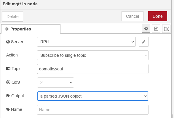

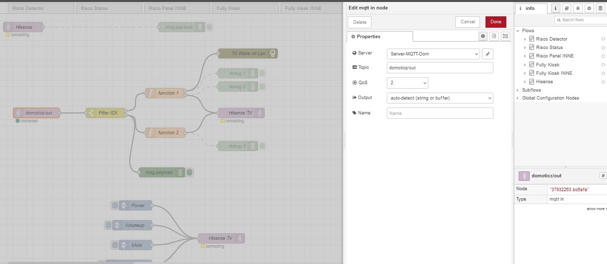

Hello @zabinskiwojciech,
I see you use an older version of Node_RED. (Version 2.x.x?) Consider an update to the latest version.
In this case you have to change the "Output" from "auto-detect (string or buffer)" to "a parsed JSON object".
See:
If you update to the latest version 3.0.2, you have another option as well.
See:
Please, try again and let me know, if it functions.
Try "On/Off" button first, before we continue with the "Selector Switch".

You are irreplaceable again, great, commands work, WOL does not work ... maybe you need to install something else in Ubuntu or change something in Nodered settings.

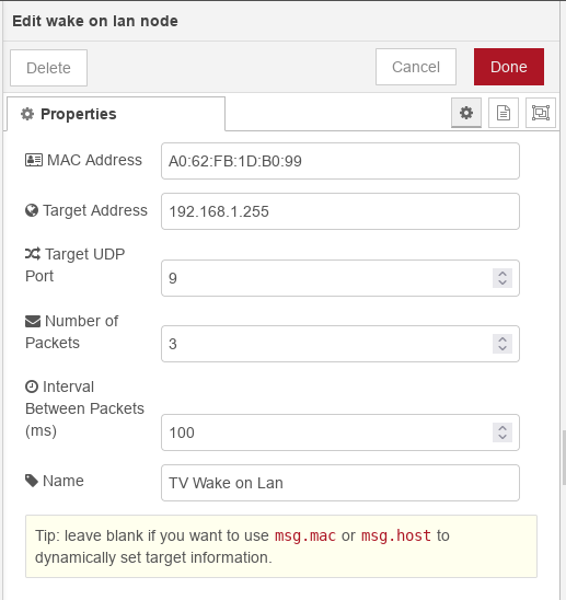

Okay,
Next check:
1. Is your MAC address correct en does it match with the MAC address of the TV?
No company is registered for your MAC address: A0:62:FB:1D:B0:99 See: https://mac.lc/
[Edit] Here it is okay: https://macaddress.io/macaddress/A0:62:FB
2. Did you change the "Target Address" to the broadcast address of your LAN: 192.168.1.255?
Next check:

192.168.1.102 0 a0:62:fb:1d:b0:99 internal
this is what i read from the router
change Target Address

Hello.
I fell down and I managed to start WOL, I had to change the card on the virtual machine to RLT because the virtual Intel did not support G packets. I made the settings according to the guide from the link:
https://necromuralist.github.io/posts/e ... ke-on-lan/
