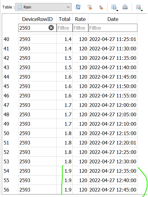

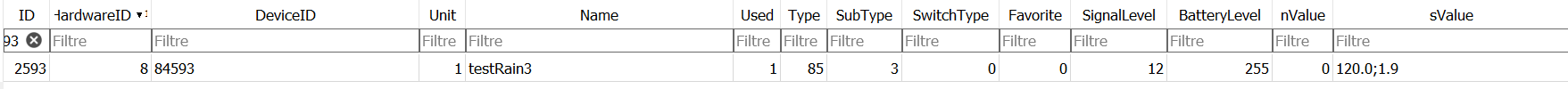

Last run
2022-04-27 12:30:01.479 Status: dzVents: !Info: A_Rain: rainTot initial: 1.7000000476837
2022-04-27 12:30:01.479 Status: dzVents: !Info: A_Rain: rainVal : 120.0;1.8
2022-04-27 12:30:01.479 Status: dzVents: !Info: A_Rain: rainValTot : 1.8
2022-04-27 12:30:01.480 Status: dzVents: !Info: A_Rain: rainTot increases: 1.9
Screenshot 2022-04-27 124237.png (17.09 KiB) Viewed 252 times
at 12:44
should have been 1.9 instead of 1.8
Screenshot 2022-04-27 124719.png (38.76 KiB) Viewed 252 times
Screenshot 2022-04-27 124940.png (9.19 KiB) Viewed 252 times
For the rain: "Number (please note that this does return the rain total for today" I need to wait for tomorrow the see if it is today or not ; idem for sValue
