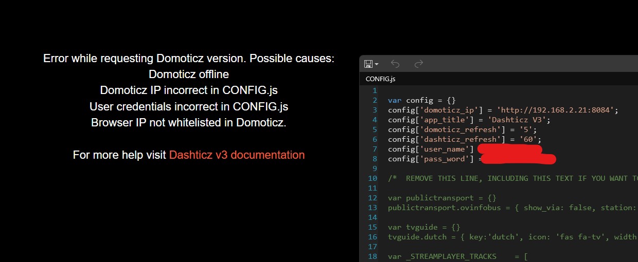

I've got same error and don't understand the mentioned solution.
Domoticz on a Raspberry and Dashticz on Synology NAS.
Please help
Screenshot 2022-08-31 163048.jpg (93.47 KiB) Viewed 1001 times

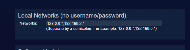

The mentioned solution is a Domoticz setting.
Settings - System Setup - Local Networks
Blah blah blah

Added the IP's in the settings of Domoticz, but didn't work.
Any suggestions? ;)
Screenshot 2022-09-02 152106.png (13.79 KiB) Viewed 974 times
