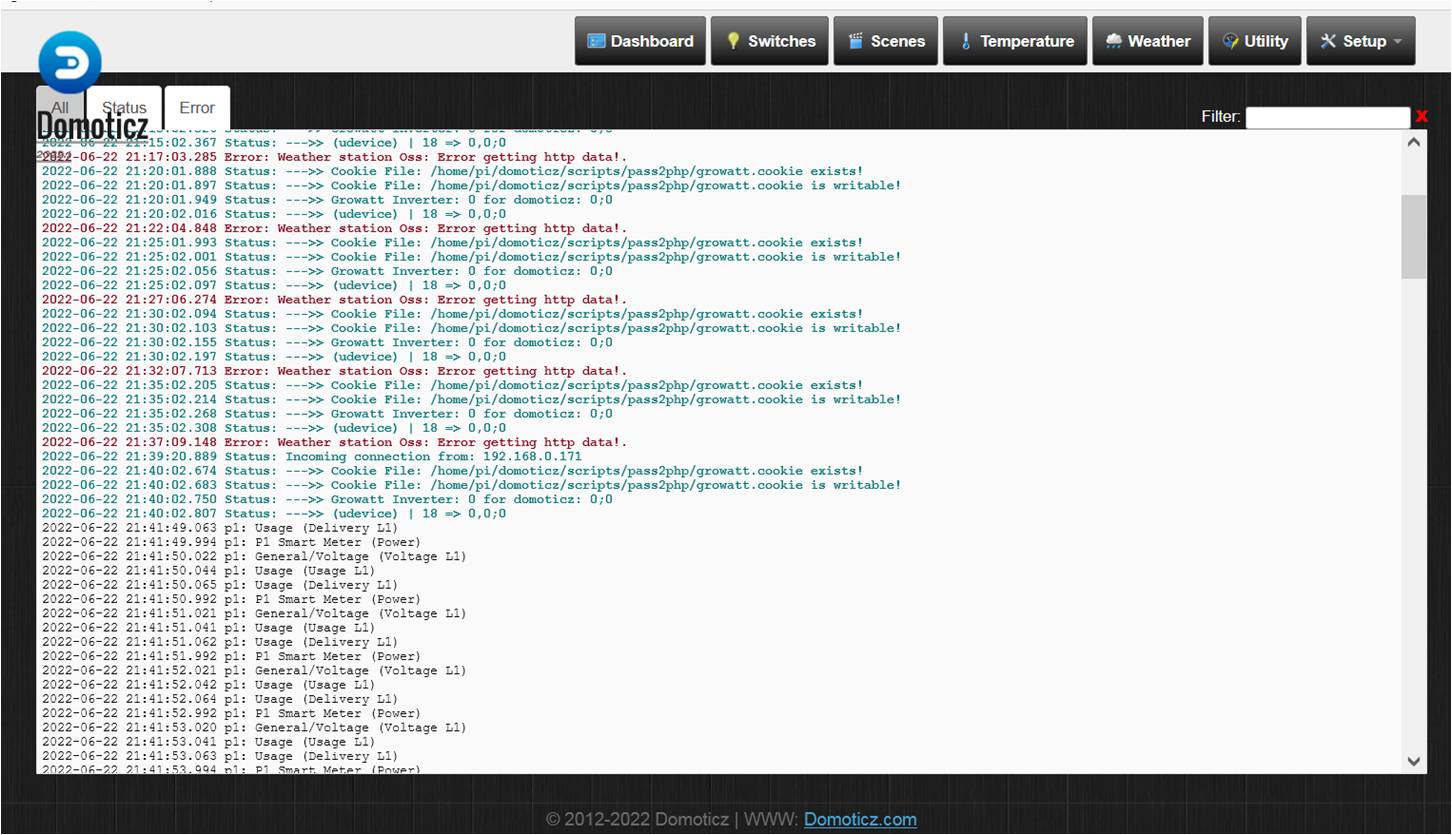

Hi everybody,
since last Tuesday my growatt inverter only displays zero values in Domoticz. Nothing has changed, so this puzzled me. I found this thread and I updated the script according to sincze's suggestions. However, now my growatt device is colored 'red' in Domoticz, so it is not updating values at all anymore. Anybody experienced this before or do you have suggestions how to fix it?
Best regards, Michiel.

Re: Growatt shows minus value since update of domoticz
That is weird indeed script and plugin are working here.
Is the URL https instead of http ??.

mvanrijnbach
- Posts: 20
- Joined: Monday 20 June 2022 21:37
Hi sincze,
the URL is: http://server-api.growatt.com/newLoginAPI.do
I didn't change the script until the zero values started to show up. I made the changes you suggested.

mvanrijnbach
- Posts: 20
I didn't have negative values, but zero values from one day to another. Now I updated the script according to your suggestions in this thread, but now the inverter does not update in Domoticz at all. I'll attach the updated script in this post, maybe you'll the problem right away. BTW, what is the purpose of the growatt cookie?

mvanrijnbach
- Posts: 20
With the old script the login was successful (I could also see this in the log). With the adjusted script I do not receive any values.
mvanrijnbach
- Posts: 20
If I return to the old script (the one from github) the growatt domoticz device is updated again, but with zero values again.

mvanrijnbach
- Posts: 20
Problem solved.
I took the latest script from incze's github and now it works again. Apparently, there have been some changes in the script with respect to the version I had. As far I can see the login form has changed on the 16th of June, so that's probably why I started seeing zeros since mid June:
define('LOGIN_FORM_URL', 'http://server-api.growatt.com/newLoginAPI.do'); // URL of the login form.
define('LOGIN_ACTION_URL', 'http://server-api.growatt.com/newLoginAPI.do'); // Login action URL. Sometimes, this is the same URL as the login form.
became
define('LOGIN_FORM_URL', 'https://server-api.growatt.com/newTwoLoginAPI.do'); // 16-06-2022: URL of the login form.
define('LOGIN_ACTION_URL', 'https://server-api.growatt.com/newTwoLoginAPI.do'); // 16-06-2022: Login action URL. Sometimes, this is the same URL as the login form.
There are some other changes in the script, but this must have been the culprit.
became
