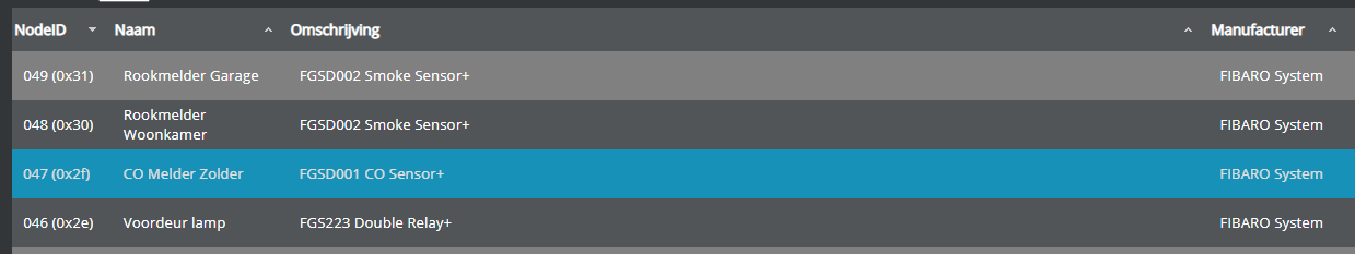

For some reason is the description (type number) of 1 sensor not correct.
In the .xml file it is mentioned correctly, so i don't know why is is not correct.
The CO-sensor is type FGCD001 instead of FGSD001.
Not a big issue, but i just wanted to get it correctly and also curious how to change it for the future

I've found where the wrong description is coming from.
In the file /openzwave/manufacturer_specific.xml is the type mention incorrectly.
After changing this description, deleting ozwcache_0xcf73f398.xml and restart domoticz it is now correclty in Domoticz.
