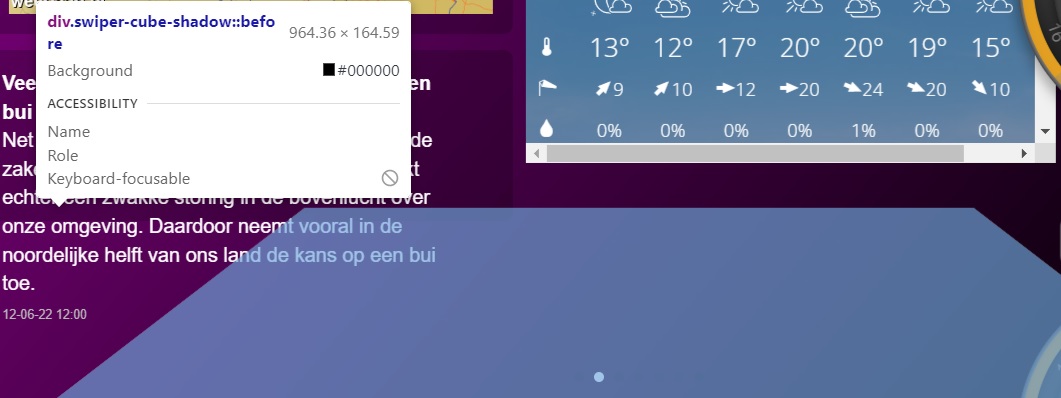

I have a strange problem with a few of my Dashticz screens.
On screen 2 and 6 I cannot change or click on anything on the screen.
Not even a google map or the OWM widget.
Only the screen select buttons at the bottom work.
When I use the element selection tool in the developer console, is looks as if the whole screen in one element.
It gets highlighted and this is shown:
Dascticz screen problem.jpg (48.22 KiB) Viewed 768 times
As a test, I copied the settings for screen 1 to screen 2 in config.js. So both screens have the same columns. Screen 1 works ok, screen 2 still having the same problem.
I updated from 3.8.11 beta to 3.9.5 beta, but this had no effect.
Any idea what the problem can be?

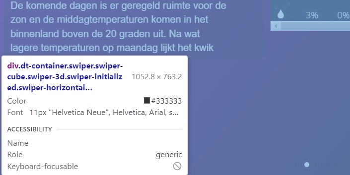

I checked different browsers, also inprivate en Fully Kiosk. All have the same problem with screen 2 and 6.
This shows if I move the mouse to the lower end of the screen while in element select mode in developer console:
Dascticz screen problem2.jpg (78.73 KiB) Viewed 729 times
Left and right also highlight triangles.
Look like something is positioned over the actual screen.

Which swipe effect do you use?
Can you try with the default setting?
Verstuurd vanaf mijn SM-A526B met Tapatalk
toro
Posts: 50
Joined: Wednesday 09 August 2017 23:05
Re: Some screens not clickable
Post by toro »
Ah Lokonli, you are on the right track!
I use the cube effect.
I have tried the others now and they al work ok. If I set it back to cube again, the problem returns.
