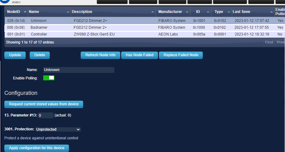

Last year I bought a Qubino and a Fibaro z-wave dimmer to see which one was best. Fibaro won, so last week I bought some more.
However, Domoticz (with a Aeotec Gen5 USB stick) does not recognize this new dimmer (NodeID 008). It says unknown, although the old dimmer (NodeID 006) was recognized without issues.
Strangely both nodes (006 and 008) have the same Type, whatever that means.
Does anybody know how I can solve this issue so I can start using this dimmer?

The device has a new ID that is not yet specified in the manufacturer_specific.xml
I fixed it by manual adding this device by adding a new line in the fibaro chapter with
<Product config="fibaro/fgd212.xml" id="1001" name="FGD212 Dimmer 2" type="0102"/>
assuming the device works similar to the old o==device with id=1000.

I have made the file change. But no configuration by 'Unknown'
xmanpower
Joined: Thursday 12 January 2023 17:01
Re: 2nd Fibaro Dimmer 2 (FGD212) not recognized in Domoticz
Post by xmanpower »
solved, after unlinking and unsecured linking, you will see the correct configuration.
