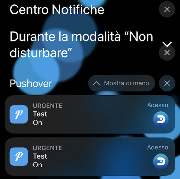

If I change state of irrigatore device, I expect a push notification, but I have twice notification.

and the push notification are two, like the screenshot shows:
I think is a bug, or a big mistake in the script.
