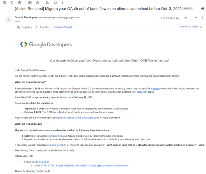

Hello
I find this post on discord
What do you think about that...
DGZA is out the 3 october?
Or have you a solution?
Thank's for the help
mgugu
Posts: 226
Joined: Friday 04 November 2016 12:33
Location: France
Re: Domoticz-Google-Assistant (dzga)
Post by mgugu »
This concerns all Google projects which are in production mode. Its is normally up to the developer to update.
This does not concern projects in test mode which is (fortunately) the case for the nodered Google smart home project that I use.
I also use Google assistant relay project, in production mode and developer has produced un update, but complete configuration becomes necessary.
The migration process is discussed here https://github.com/greghesp/assistant-relay/issues/272

Just curious, do you know why this is now necessary? Before the link with Google Home worked fine without this parameter.
I added some new funktions but that is fixed now in latest
