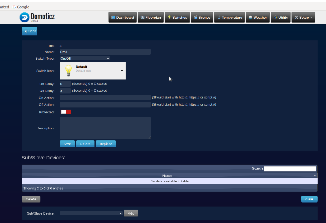

Go to the switches tab and edit first DM1 and then DM2 as follows: enter 3 in the off delay field and save
You now have the 2 dummy devices that will switch off after 3 seconds when switched on.

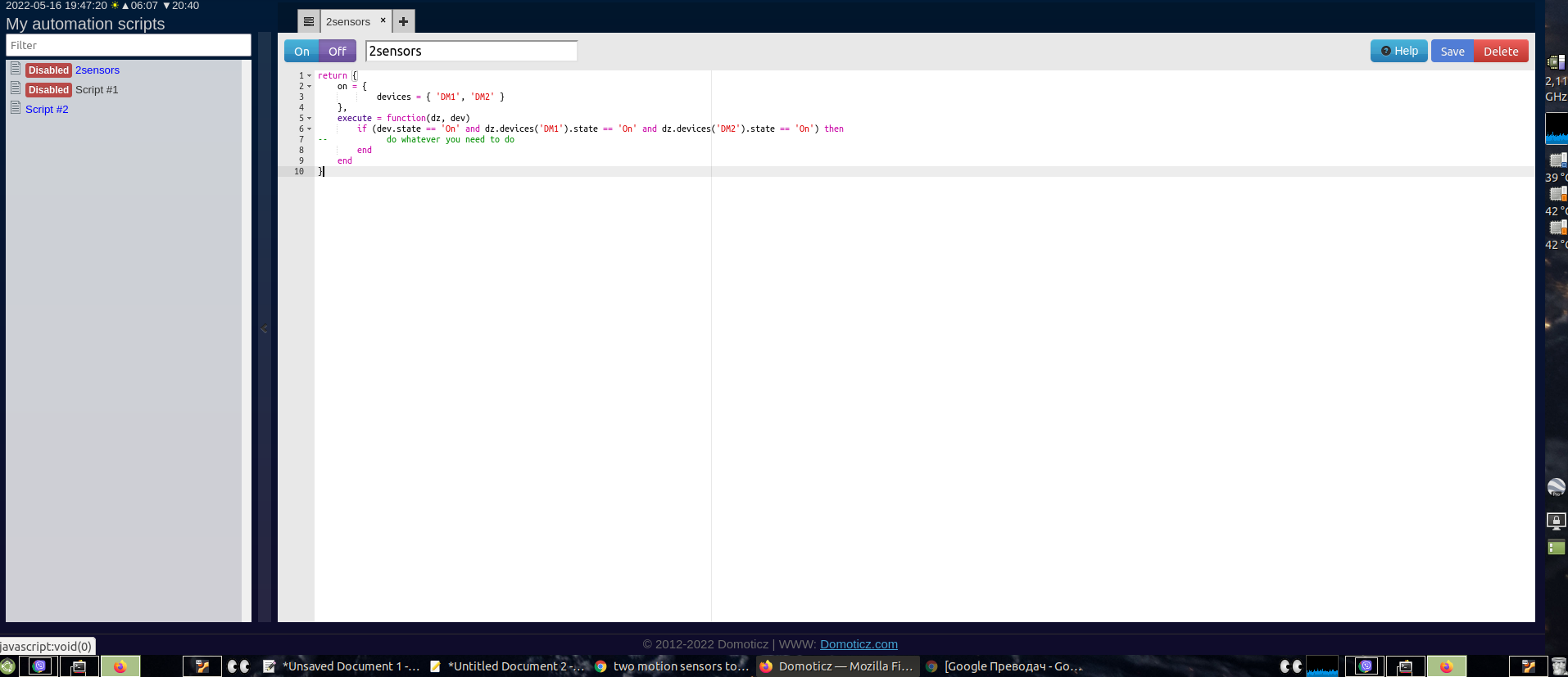

I followed your code, but maybe I'm missing something. Someone option may need to be included or the path of the code to specify?
I don't know where the mistake is. The code does not generate any error, but still receives notification from only one sensor / switch.
Would you look at the video I made so we could finish the project?!
This is my setting and script => https://youtu.be/nVjCk2Sbmps
This step is very important to me!

There was a typo in my second script where it chedcked for DM1 twice instead of testing for DM1 and DM2:
I tested it myself and it works.

Re: two motion sensors together to active notification
to understand! now I saw the mistake too, but I think it should be as it is written. so I just copied it.
changed DM1 to DM2. just like you say change it!
upload a screenshot to take a look please.

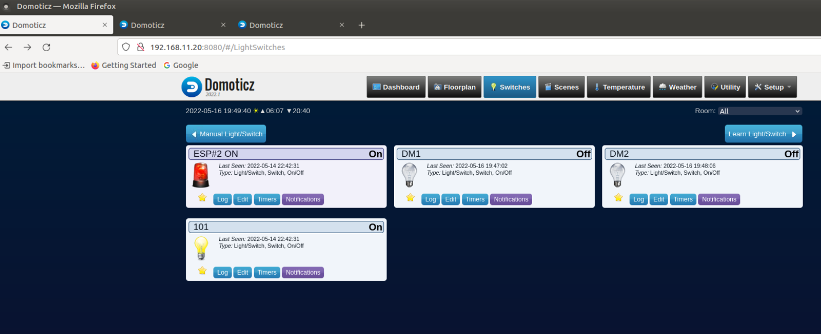

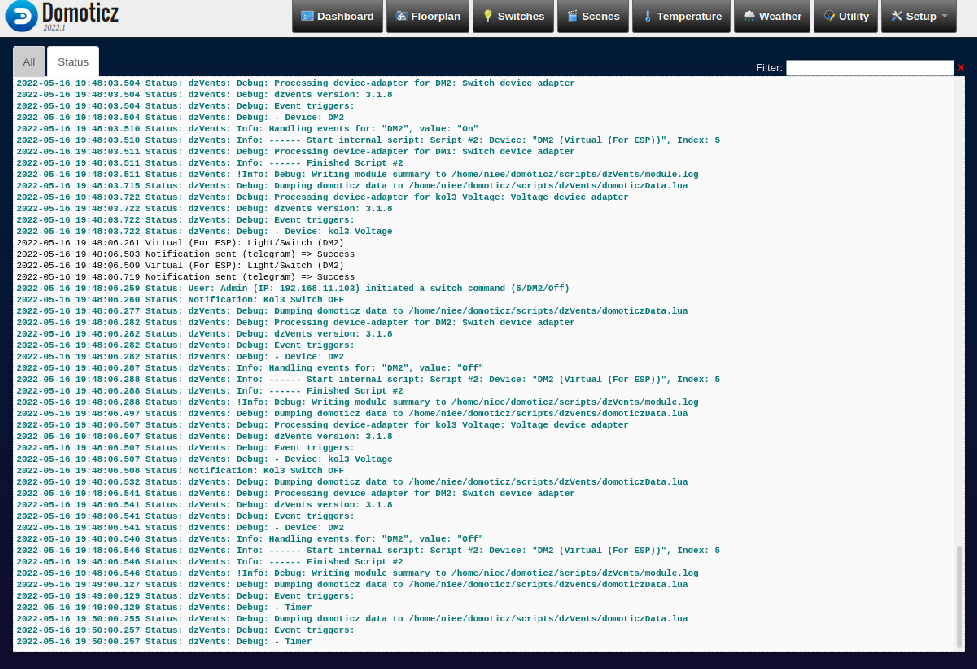

please take a look at my settings as well. do I have to describe the path of the script somewhere or something else?
I still receive notifications from only one sensor.
looking at the logos there is no mistake. maybe I missed something somewhere. if I have to shoot somewhere else some setting?

Re: two motion sensors together to active notification [Solved]
Your mistake is activating notifications for each switch.
You need to add a notification in the script, or add a third virtual switch that will turn on when the first two are ON
Then the third switch may have an active notification
DM1 = no notifications
DM2 = no notifications
DM3 = notification but then DM1 and DM2 = ON
or This script is what colleagues suggest but
