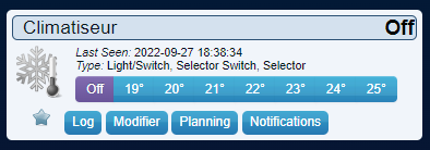

Re: Python Plugin : Broadlink
Hello everyone and congratulations to zak45 for this very useful plugin.
I would like to create a switch in Domoticz with several options to easily select the temperature of an air conditioner :
For this pupose, I want to use the following command with several .ini files:
But in the log, I get this message:
On a browser, with the same command, the screen shows "Broadlink not know what to do!"...
Can you give me the exact syntax of the command?
http://10.0.0.11:9000/SendCode?key=AABBCCDDEEFF?ini=Broadlink-7-010.iniCode: Select all

Hi, should be something like this: (replace second ? by &)Aile wrote: Tuesday 27 September 2022 18:51Can you give me the exact syntax of the command?Code: Select all
http://10.0.0.11:9000/SendCode?key=AABBCCDDEEFF&ini=Broadlink-7-010.iniRe: Python Plugin : Broadlink
I tried too, but the response is the same: "Broadlink doesn't know what to do!"zak45 wrote: Tuesday 27 September 2022 23:51 Hi, should be something like this: (replace second ? by &)Code: Select all
This button does not work, as well as the "#" button, while the "edit" button works.zak45 wrote: Tuesday 27 September 2022 23:51 Tip: On the plugin Admin web page, for each captured command (RF or IR) , if you click on the World Icon (http link), should appear the http command for the corresponding ini file...
I also can't use the "View Code" button.
Maybe I have to delete the order to recreate it?
However, the air conditioner receives the order and executes it when I press the button created in Domoticz.
Nothing happens when I press the "Send code" button in the plugin Admin web page.
