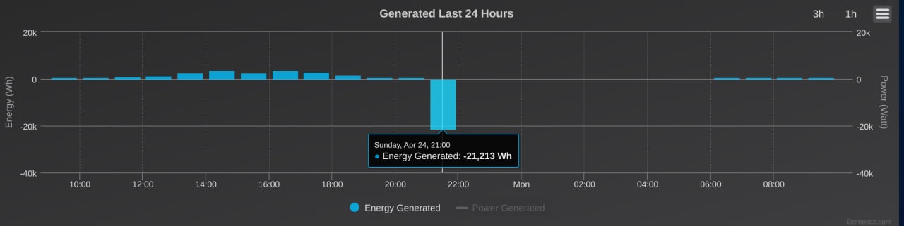

And this are the scores of PVoutput. Just single production. I don't have a P1-meter, so not even able to read consumption..
In the DASHBOARD: The actual power is correct. The dayly production is wrong..
And very strange is that in the list of "Devices" the dayproduction shows the right actual value....
Probably not related to Node-Red. Guess I have to open a new question for this problem.

But in Domoticz is useless. Cannot explain why every night at around 3:00 there is a very big negative value.. Not related to the score of the day before. And I don't know if this is caused by Node-Red or just Domoticz...
This is strange indeed. We use as virtual sensor "Electric (Instant + Counter)", don't we?
It just happened to me about a week ago that I had the same with another user. However, he has a Fronius inverter.
That should not make any difference with your application.
His inverter had the issue at 21:00 h. We have explained that the it is on the limit of production/no production as approx. 21:00h it is currently getting dark. In his case he has put the Energy read to "From device". When he changed that to "Computed" it was solved.
How is your setting?
See his picture below
In the DASHBOARD: The actual power is correct. The daily production is wrong..
This is probably caused by that negative spike.

@PieterS and @Firewizard, same problem here.
I created a dummy electric (instant + usage) device that gets it data over MQTT from HASS (because HASS has a perfectly running plugin for my Huawei inverter).
It's working perfectly fine, but every morning at exact 06:00 I get a big negative value (seems to be the total production of the day before?).
Changing to "computed" instead of "from device" works for you @PieterS?
Like you say, if I go the see in the "Devices" menu, it shows the correct value however. Very strange.
I guess that the inverter "resets" the daily yield and thus changes from eg: 32,5kwh to 0kwh at 06:00 resulting in a big negative value. Other brand inverters can do this at other times (at night/after sunset/...).
Searching a way to filter out this big "reset" each morning.

I think I found a possible "solution".
The "Daily Yield" gets reset to 0 everyday. It seems to happen at a different time with each different brand of inverters. Say I've got a Daily Yield of "30"kWh on 02/05/22, then it would reset to "0"kWh at 06:00. This negative reset value of -30 seems to be included in the calculations. I don't know if this is a bug or by design?
If you use "Total Yield" however, the data never gets negative, it get's bigger everyday (eg. Total Yield= 130kWh + 30kWh today = 160kWh). This one only increases.
I guess Domoticz counts the difference each day itself.
I hope this doesn't sound too complicated?
So the negative spike will probably be as big as the daily usage of the day before, because it resets to 0.
You are completely right. Perfect.
We should not send the Daily yield to Domoticz but the Total yield.
In case of "Computed", this value is completely ignored, as it is calculated by Domoticz, while in case of "From device", the Daily yield is also calculated by Domoticz, but based on the Total yield.
And sorry for that, I should have remembered that.
See: viewtopic.php?p=221565&hilit=energy+ins ... er#p221565
About 3 years ago I had a long discussion with Rens van Waardenberg, waaren (RIP).
Indeed a day_counter has to be reset every day/night and this works only by subtracting the previous Day yield. So it is not a bug, but by design.
What to do?
In all MQTT messages to Domoticz , we should replace the last value in the svalue part from "Daily yield" to "Total Yield"
For @PieterS, I will correct my latest flow, while i will PM @phenix56 and send an update.

Let me know the result.
PieterS
Posts: 198
Joined: Wednesday 31 May 2017 16:06
Domoticz version: 2024.7
Re: Join several dataloggers and calculate values in Node-Red
Post by PieterS »
Hello @FireWizard,
Thanks for your attention and new flow. I am not able to make changes to Node-Red and Domoticz at this moment. Will pick it up later and let you know the results.
By the way, as you can see, the negative value is not every night. Two nights at a row: no negative pile. Possible due to editing the device Energy read to Computed...?
I can not relate the negative value to the positive value of the day before. You can check it if you compare the results of PVoutput.org and the grapic of Domoticz in my reply of sunday 01 May 20:31.
Very curious behaviour, in my opinion.
Besides that: Node-Red does not send data to Domoticz during the night, because of the time-node..
Best regards,
Pieter
Synology with Domoticz build (V2024.7) in Docker
sammyke007
Posts: 204
Joined: Monday 08 May 2017 20:48
Domoticz version: 2022.1
Location: Belgium
Post by sammyke007 »
Seems to work fine with the total yield instead of the daily yield!
