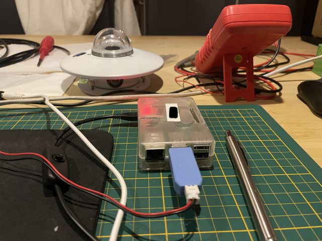

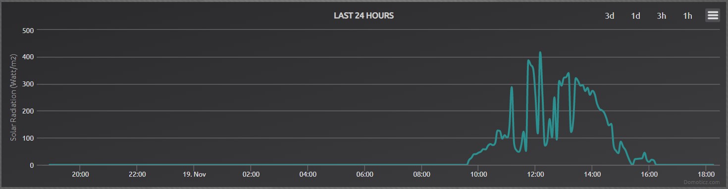

Thanks to @Domoticx and everyone else who contributed to the development of this plugin. I now have a SEM228T pyranometer running on it. The first test from the balcony is promising.
Schermafbeelding 2021-11-19 181744.jpg (54.05 KiB) Viewed 6519 times
IMG_8387 klein.jpg (60.87 KiB) Viewed 6519 times

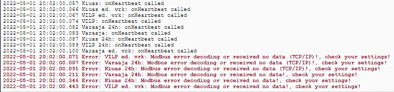

I'm getting these errors too (at least every day at random times). I have already set the polling rate to different intervals for each hardware device and I just added a 120 ohm resistor (although the lengths are short), but that didn't help either. I'm thinking about disabling the autopolling (disable the heartbeat part in the script) too and calling from a separate script. I currently have 15 devices reading from 2 different heat pumps.
I also get these random modbus errors, but I'm using modbus TCP.

Alain wrote: Monday 25 April 2022 10:52 I "solved" my problems by setting a crontab to restart Domoticz every 6 hours. This works for me, but I have to say that I don't run any other process on this pc. It's a remote server that only runs modbus for the heat pumps.
Restarting Domoticz every 6 hours ensures I don't have any errors from requests running simultaneously. This shows that that is the problem I and others have/had.
My problem seem to be different. I tried restart, but got lots of errors. So what I did I set different polling rates for different parameters, prime numbers from 11 to 43 seconds. I suspect PLC (Siemens LOGO!) doesn't handle well several modbus request at same time. Mostly works. I only get errors when multiple parameters are read about the same time.
EDIT:
I ended up putting some random sleep in plugin, like this:
@@ -173,6 +173,8 @@
import Domoticz
import sys
import pymodbus
import time
import random
from pymodbus.client.sync import ModbusSerialClient # RTU
from pymodbus.client.sync import ModbusTcpClient    # RTU over TCP
@@ -324,6 +326,7 @@ def onDisconnect(self, Connection):
        Domoticz.Log("onDisconnect called")
    def onHeartbeat(self):
	time.sleep(random.random()*5)
        Domoticz.Log("onHeartbeat called")

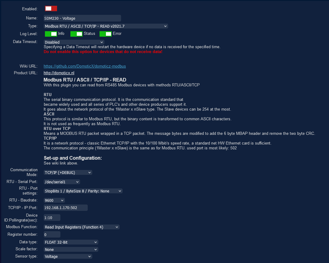

Firstly, thanks to those who have worked on this ; I'm hoping I can make use of this neat device soon!
I've been struggling to get things running, and have thoroughly read through this entire thread twice now.
The device :
rpi4 with lastest distro, uptodate and upgraded etc.
Stable Domoticz 2022.1
First thing I'd like to point out, it that in my case, I've also had to install python3-dev for the "Modbus RTU etc" devices to show up in the hardware list. Hope that'll be of use to someone.
Now, my next issue, is simply that a Modbus hardware is getting the whole domoticz to hang. Actually, it still lists as "+" in the sudo service --status-all commandline, but this is what I then have to do to regain control :
sudo service domoticz stop
sudo sqlite3  -header -list /home/pi/domoticz/domoticz.db "UPDATE Hardware set Enabled = 0 where ID = 8"
sudo servive domoticz start
