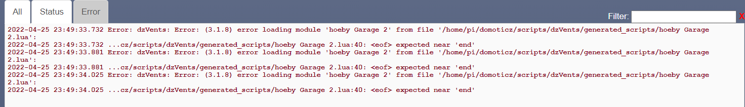

The script was giving me an error on line 40 where was "end & }" so i removed them and no error anymore. Then when i press "Garage 2 Door" it doesn't trigger "Garage 2 Relay". When i simulate that ("Garage 2 Sensor Closed" == On ) it doesn't run " ('Garage 2 Door').switchOn().silent() ". I noticed that when the "timer = { 'at nighttime' }" is added this way is taking action every complete minute and also the script is checking every minute , but if is this way if (domoticz.time.isNightTime and switch.state == 'On') it is reacting immediately. If i am not wrong the same kind of timer problem was mentioned on another thread.
Screenshot (518).png (39.61 KiB) Viewed 792 times

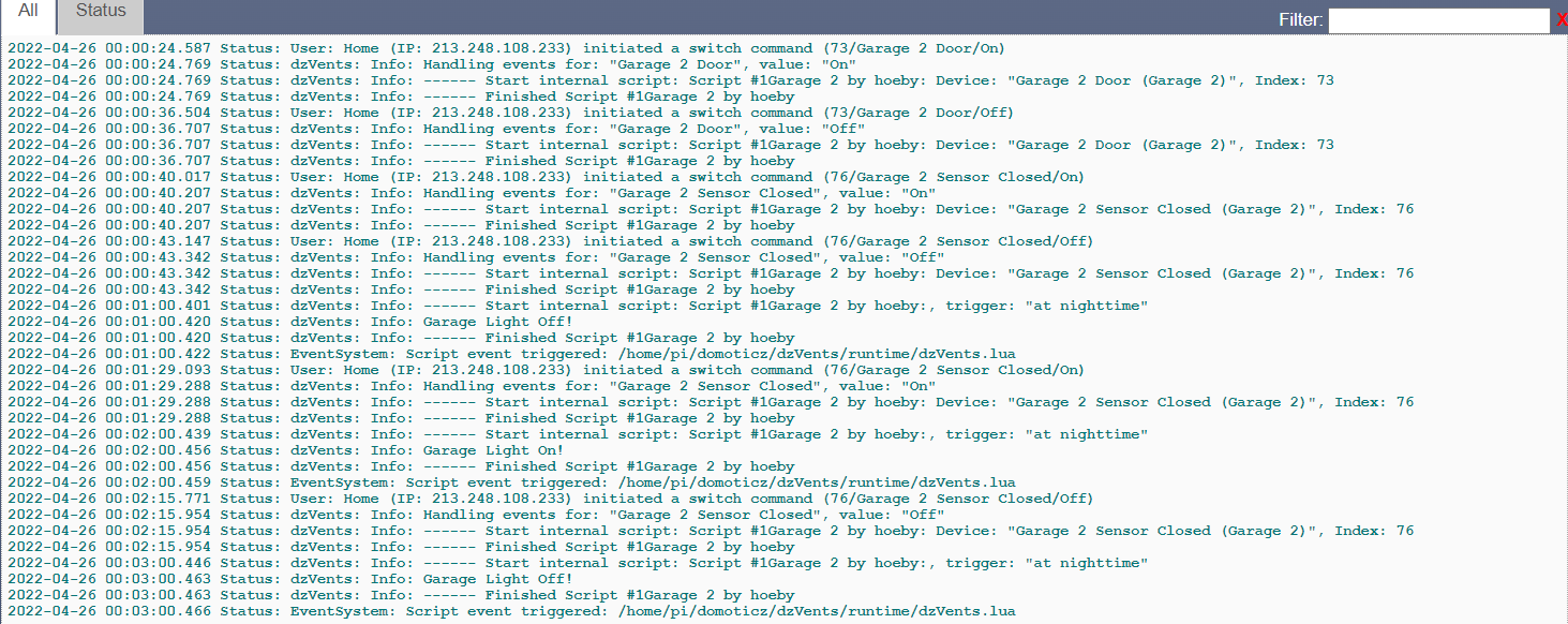

You where correct, it wasn't working, sorry my fault.
Made some changes
Only tested the "Garage 2 Door" reaction. that works in my environment.
That you get a trigger every minut is correct.
"timer = { 'at nighttime' }" means between sunset and sunrise. This will be checked every minut and therefor it is every minut true when it is between sunset and sunrise. If you need to let the timer work at 00:00hour. Then you need to modify 'at nighttime' to 'at midnight'
This line isn't going to work correctly (domoticz.time.isNightTime and switch.state == 'On')
