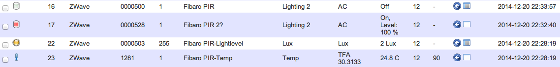

The Fibaro Motion sensor - I am a bit confused why the PIR sends two messages for motion - one with a level of 100%:

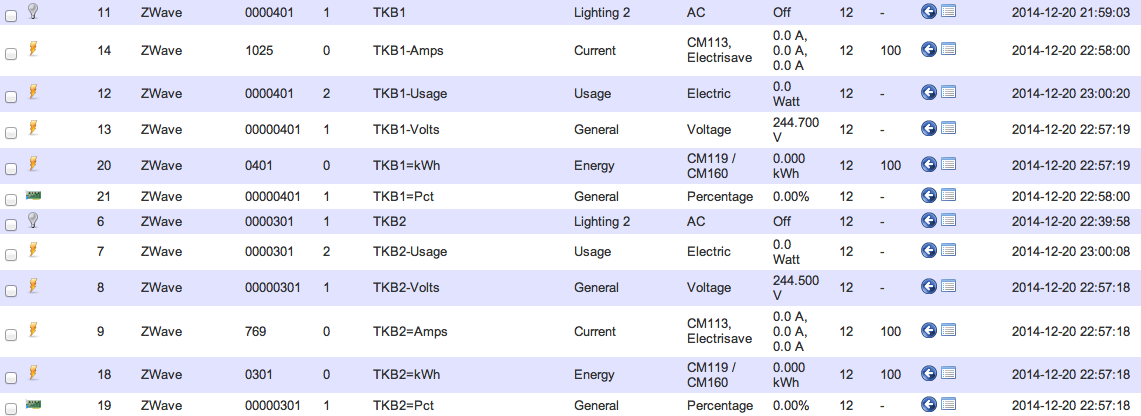

The two TZ88E devices - oddly the energy classes claim it is an CM119/113/160:

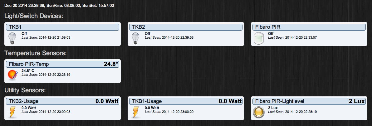

It would be really nice if Domoticz could combine the messages into a single graphic in the portal but it's fine for now.

In my system, the FGMS001 shows a tamper switch alarm which, in some operating modes, can act as a vibration sensor. Perhaps this is the source fo your "extra" switch?

Thanks Tony. That could be it!
