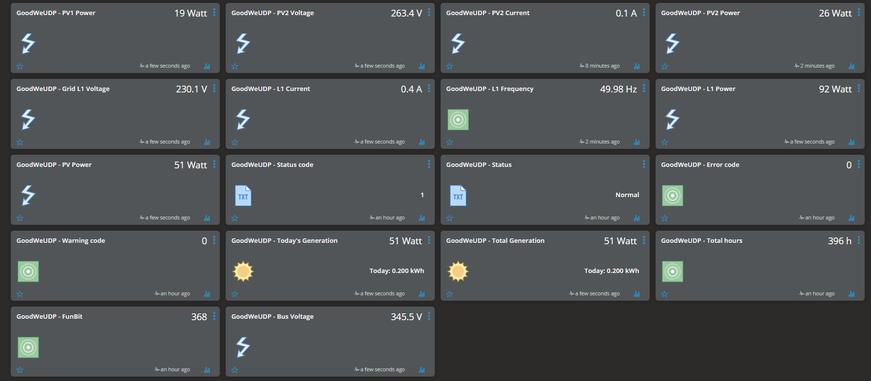

I created a plugin for Domoticz for local readout of a GoodWe inverter via modbus over UDP.
Works via LAN and WLAN. For XS inverter is firmware 1.xx.14 or higher required. Other GoodWe inverter model series (ET, EH, BT, BH, ES, EM, BP, DT, MS, NS) might work as well.
Currently the plugin is in working order but isn't (yet) in a shape to be released, so I'm looking for some beta testers to start in a couple of days. Please send me a message and I'll be contacting you back in a few days with some details to get you started.
Whenever you want to help beta testing I expect this from you:
1. You are familiar with Domoticz, know how to install and configure a plugin.
2. You are familiar with reading the Domoticz logs and are able to extract data from that to send to me.
3. You have a GoodWe inverter with the required firmware (For XS series firmware 1.xx.14 or higher) with a Wifi of LAN module which has been proven to already work with modbus over UDP on port 8899.
4. You have insight in your energy delivering stats (not in Domoticz, but in Sems, for example) so you can compare numbers between different systems.
5. You install and use the plugin at your own risk. If, for any reason, things break down, you lose data, Domoticz dies or anything else; its your own risk.
Edit: Hope this forum allows you to send me a PM or e-mail, so try that. Otherwise, maybe just reply below (without giving your e-mail address or other personal info in the post), then we will find another safe way to get the info.
Its only vintage if it works.

Hi, Took a little time(Bullseye and Python do not get along)
Updated Domoticz to beta and the plugin is now functional.
Did have to manually install pymodbus via 'pip install pymodbus' perhaps this should be added to 'requirements.txt'
Also notice that you have to have 'Accept new Hardware Devices' enabled or it will fail to create devices.
My Inverter is 3600T-DS with Wi-Fi module.
I do notice that today's and total generation don't match the device setting. In devices the total is 622, on the dashboard it started at 0 and is now being totalled.

bvdf0251 wrote: Sunday 10 July 2022 13:05 Did have to manually install pymodbus via 'pip install pymodbus' perhaps this should be added to 'requirements.txt'
Thanks, I added this to the requirements.
I'm fairly new to Domoticz, about 3 to 4 weeks, this setting is in Setup->System, and I believe its normal that you need to enable it for devices to be added by plugins? And therefore device creation will fail if disabled. Or do you mean something else?
Noted as a reported working inverter.
I believe this is normal as Domoticz didn't get the 'start of the day' value in the beginning of the day. Looking at other inverter plugins (I have a SolarEdge inverter as well), this looks the same.
I think if you have a look at it tommorow for that day, it should match up.
I pushed a new version with the above changes: beta-release-v0.0.2

Yes I meant that setting. I've been using Domoticz for some 2 years now but never actually used a plugin till now.
It's no problem just something that I noticed.
As for the daily generation I understand that because of the timing I don't get everything today, however when you check the device in 'devices' it does show the correct daily generation. Meaning the data is there.
Same for the total generation.
https://drive.google.com/file/d/1ReKbSX ... p=drivesdk
https://drive.google.com/file/d/1Rblyhx ... p=drivesdk
Would be nice if we can get this data in the database so I have the total amount generated accurately.

HI there. I have the plugin running but it seems i can't get data from the inverter. Could it be that i'm running an older firmware? Where can i check the version of it?
2022-07-24 11:18:54.504 Error: Goodwe UDP: Call to function 'onHeartbeat' failed, exception details:
2022-07-24 11:18:54.505 Error: Goodwe UDP: Traceback (most recent call last):
2022-07-24 11:18:54.505 Error: Goodwe UDP: File "/usr/local/lib/python3.7/dist-packages/goodwe/inverter.py"„ line 108, in read_from_socket
2022-07-24 11:18:54.505 Error: Goodwe UDP: result = await command.execute(self.host, self.timeout, self.retries)
2022-07-24 11:18:54.505 Error: Goodwe UDP: File "/usr/local/lib/python3.7/dist-packages/goodwe/protocol.py"„ line 109, in execute
2022-07-24 11:18:54.505 Error: Goodwe UDP: await response_future
2022-07-24 11:18:54.505 Error: Goodwe UDP: goodwe.exceptions.MaxRetriesException
2022-07-24 11:18:54.505 Error: Goodwe UDP: During handling of the above exception, another exception occurred:
2022-07-24 11:18:54.505 Error: Goodwe UDP: File "/opt/domoticz/userdata/plugins/domoticz-goodwe-modbusudp-plugin/plugin.py", line 361, in onHeartbeat
2022-07-24 11:18:54.505 Error: Goodwe UDP: _plugin.onHeartbeat()
2022-07-24 11:18:54.505 Error: Goodwe UDP: File "/opt/domoticz/userdata/plugins/domoticz-goodwe-modbusudp-plugin/plugin.py", line 219, in onHeartbeat
2022-07-24 11:18:54.505 Error: Goodwe UDP: runtime_data = asyncio.run( self.inverter.read_runtime_data() )
2022-07-24 11:18:54.505 Error: Goodwe UDP: File "/usr/lib/python3.7/asyncio/runners.py", line 43, in run
2022-07-24 11:18:54.505 Error: Goodwe UDP: return loop.run_until_complete(main)
2022-07-24 11:18:54.505 Error: Goodwe UDP: File "/usr/lib/python3.7/asyncio/base_events.py", line 584, in run_until_complete
2022-07-24 11:18:54.505 Error: Goodwe UDP: return future.result()
2022-07-24 11:18:54.505 Error: Goodwe UDP: File Yusr/local/lib/python3.7/dist-packages/goodwe/dt.py", line 156, in read_runtime_data
2022-07-24 11:18:54.505 Error: Goodwe UDP: raw data = await self. read from socket(self._READ_DEVICE_RUNNING_DATA)
2022-07-24 11:18:54.505 Error: Goodwe UDP: File "/usr/local/lib/python3.7/dist-packages/goodwe/inverter.py", line 114, in_read_from_soccket
2022-07-24 11:18:54.505 Error: Goodwe UDP: self._consecutive failures count)
2022-07-24 11:18:54.505 Error: Goodwe UDP: goodwe.exceptions.RequestFailedException: ('No valid response received even after 3 retries', 1)
On the other side it is showing 19 out of 34 values so data is coming trough in domoticz.
I also noticed when UDP is active, no SEMS portal data is coming trough. Is this because of the intercept of data?

I have a GW5000D-NS, which is a single phase, dual input inverter, running software V1.1.2.1
This plugin in its current form does not work for my model. I have managed to get it working by making a few changes.
The biggest issue seems to be the detection of single vs 3 phase in the plugin. It tries to read vgrid2 and vgrid3, which fail (around line 315 in the code). By changing that part to force it always to single phase I got it to work.
For your reference, this is the output of my inverter from the first sample script:
timestamp:               Timestamp = 2022-09-12 20:02:28

And it generates these sensors:
There are a few that don't seem to be reporting the correct value. I will give a stab at it trying to figure out what to change to get it to work correctly.
