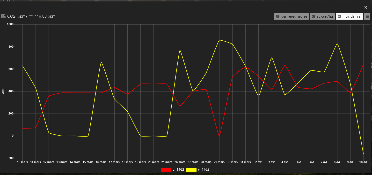

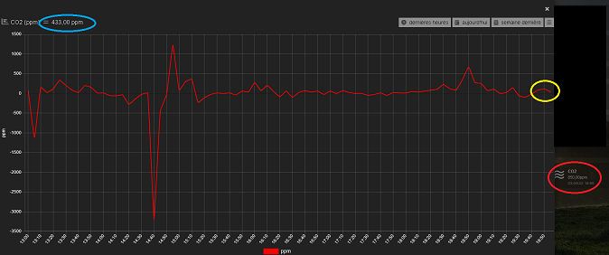

popup graph with rfxmeter counter
lgouj
Joined: Saturday 30 October 2021 15:53
Post by lgouj »
Dashticz 3.9.5 beta
Running on a raspberry pi
I have a block containing a RFXmeter counter (custom CO2 sensor). This block is working fine on the dashboard (see picture, right part, red circle, value of 850ppm). The value is updated every 30s. However, the custom popup graph displays strange results, with negative values sometimes, nothing to do with the countertoday (blue circle, which seems to be right). If I don't put the data section in the code, a black window appears, with just the title. Is there something wrong with the data name ?
popup graph_small.png (52.7 KiB) Viewed 691 times

Lokonli wrote: Monday 04 April 2022 20:35 Do you also see negative values when you select 'dernieres heures' or "aujourd'hui"?
Yes it is
Lokonli wrote: Monday 04 April 2022 20:35 If you remove 'groupBy' and 'aggregate' parameters from 'semaine derniere' do you then see the correct values?
Nothing changes, the popup window is black, with only the title in both cases.

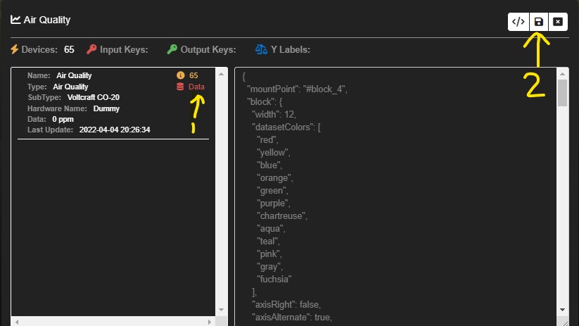

Can you add a debug button:
blocks['popup_CO2'] = {
        title: 'CO2 (ppm)',
	legend: true,
	devices:[1462],
        graph: 'line',
        debug: true,
Click on "aujourd'hui". Then click on the hamburger menu in the graph (upper right) -> Show Data
and then on
(1) Data. Copy/paste the browser output here please
(2) Save button. Download the json file, and attach it here as well.
Finally:

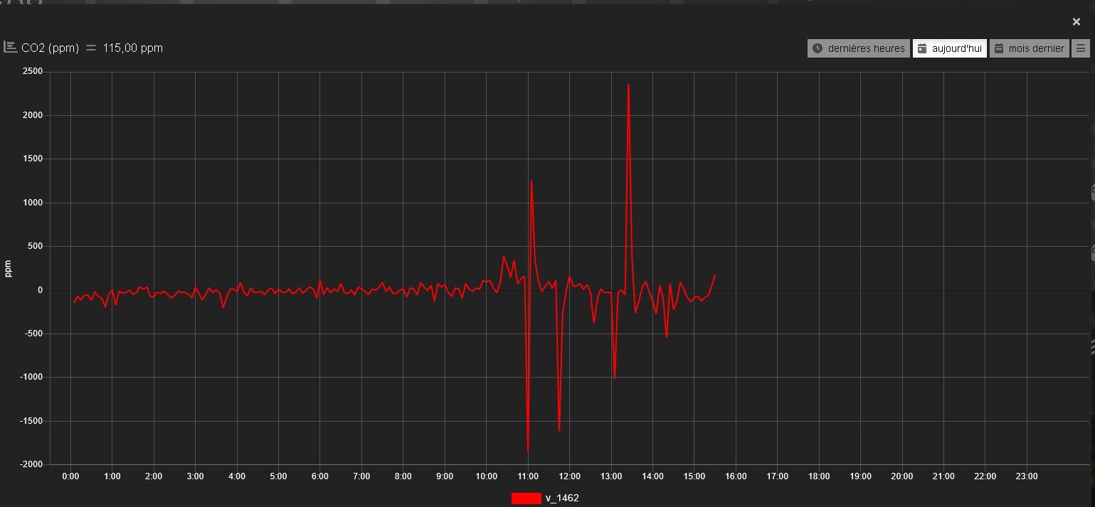

Can you add a screenshot of the Domoticz graph for the current day, as well as for last month.
lgouj
and then on
data:

			"d" : "2022-04-10 02:30",
			"v" : "-60"
			"d" : "2022-04-10 02:35",
			"v" : "-12"
			"d" : "2022-04-10 02:40",
			"v" : "-24"
			"d" : "2022-04-10 02:45",
			"v" : "-24"
			"d" : "2022-04-10 02:50",
			"v" : "-48"
			"d" : "2022-04-10 02:55",
			"v" : "-84"
			"d" : "2022-04-10 03:00",
			"v" : "33"
			"d" : "2022-04-10 03:05",
			"v" : "-36"
			"d" : "2022-04-10 03:10",
			"v" : "-108"
			"d" : "2022-04-10 03:15",
			"v" : "-48"
			"d" : "2022-04-10 03:20",
			"v" : "24"
			"d" : "2022-04-10 03:25",
			"v" : "-24"
			"d" : "2022-04-10 03:30",
			"v" : "0"
			"d" : "2022-04-10 03:35",
			"v" : "-36"
			"d" : "2022-04-10 03:40",
			"v" : "-192"
			"d" : "2022-04-10 03:45",
			"v" : "-84"
			"d" : "2022-04-10 03:50",
			"v" : "12"
			"d" : "2022-04-10 03:55",
			"v" : "12"
			"d" : "2022-04-10 04:00",
			"v" : "-12"
			"d" : "2022-04-10 04:05",
			"v" : "84"
			"d" : "2022-04-10 04:10",
			"v" : "-24"
			"d" : "2022-04-10 04:15",
			"v" : "-60"
			"d" : "2022-04-10 04:20",
			"v" : "24"
			"d" : "2022-04-10 04:25",
			"v" : "-24"
			"d" : "2022-04-10 04:30",
			"v" : "-22"
			"d" : "2022-04-10 04:35",
			"v" : "-12"
			"d" : "2022-04-10 04:40",
			"v" : "-48"
			"d" : "2022-04-10 04:45",
			"v" : "0"
			"d" : "2022-04-10 04:50",
			"v" : "24"
			"d" : "2022-04-10 04:55",
			"v" : "-36"
			"d" : "2022-04-10 05:00",
			"v" : "11"
			"d" : "2022-04-10 05:05",
			"v" : "-24"
			"d" : "2022-04-10 05:10",
			"v" : "-24"
			"d" : "2022-04-10 05:15",
			"v" : "12"
			"d" : "2022-04-10 05:20",
			"v" : "-36"
			"d" : "2022-04-10 05:25",
			"v" : "-24"
			"d" : "2022-04-10 05:30",
			"v" : "24"
			"d" : "2022-04-10 05:35",
			"v" : "-33"
			"d" : "2022-04-10 05:40",
			"v" : "0"
			"d" : "2022-04-10 05:45",
			"v" : "36"
			"d" : "2022-04-10 05:50",
			"v" : "12"
			"d" : "2022-04-10 05:55",
			"v" : "-84"
			"d" : "2022-04-10 06:00",
			"v" : "108"
			"d" : "2022-04-10 06:05",
			"v" : "-48"
			"d" : "2022-04-10 06:10",
			"v" : "24"
			"d" : "2022-04-10 06:15",
			"v" : "-24"
			"d" : "2022-04-10 06:20",
			"v" : "12"
			"d" : "2022-04-10 06:25",
			"v" : "-12"
			"d" : "2022-04-10 06:30",
			"v" : "72"
			"d" : "2022-04-10 06:35",
			"v" : "-24"
			"d" : "2022-04-10 06:40",
			"v" : "-36"
			"d" : "2022-04-10 06:45",
			"v" : "0"
			"d" : "2022-04-10 06:50",
			"v" : "-48"
			"d" : "2022-04-10 06:55",
			"v" : "33"
			"d" : "2022-04-10 07:00",
			"v" : "12"
			"d" : "2022-04-10 07:05",
			"v" : "-12"
			"d" : "2022-04-10 07:10",
			"v" : "-48"
			"d" : "2022-04-10 07:15",
			"v" : "12"
			"d" : "2022-04-10 07:20",
			"v" : "0"
			"d" : "2022-04-10 07:25",
			"v" : "36"
			"d" : "2022-04-10 07:30",
			"v" : "84"
			"d" : "2022-04-10 07:35",
			"v" : "-12"
			"d" : "2022-04-10 07:40",
			"v" : "33"
			"d" : "2022-04-10 07:45",
			"v" : "-36"
			"d" : "2022-04-10 07:50",
			"v" : "-36"
			"d" : "2022-04-10 07:55",
			"v" : "0"
			"d" : "2022-04-10 08:00",
			"v" : "12"
			"d" : "2022-04-10 08:05",
			"v" : "-72"
			"d" : "2022-04-10 08:10",
			"v" : "24"
			"d" : "2022-04-10 08:15",
			"v" : "12"
			"d" : "2022-04-10 08:20",
			"v" : "-48"
			"d" : "2022-04-10 08:25",
			"v" : "84"
			"d" : "2022-04-10 08:30",
			"v" : "36"
			"d" : "2022-04-10 08:35",
			"v" : "0"
			"d" : "2022-04-10 08:40",
			"v" : "48"
			"d" : "2022-04-10 08:45",
			"v" : "-120"
			"d" : "2022-04-10 08:50",
			"v" : "72"
			"d" : "2022-04-10 08:55",
			"v" : "36"
			"d" : "2022-04-10 09:00",
			"v" : "60"
			"d" : "2022-04-10 09:05",
			"v" : "-24"
			"d" : "2022-04-10 09:10",
			"v" : "-66"
			"d" : "2022-04-10 09:15",
			"v" : "24"
			"d" : "2022-04-10 09:20",
			"v" : "12"
			"d" : "2022-04-10 09:25",
			"v" : "-84"
			"d" : "2022-04-10 09:30",
			"v" : "72"
			"d" : "2022-04-10 09:35",
			"v" : "12"
			"d" : "2022-04-10 09:40",
			"v" : "-12"
			"d" : "2022-04-10 09:45",
			"v" : "24"
			"d" : "2022-04-10 09:50",
			"v" : "12"
			"d" : "2022-04-10 09:55",
			"v" : "108"
			"d" : "2022-04-10 10:00",
			"v" : "96"
			"d" : "2022-04-10 10:05",
			"v" : "108"
			"d" : "2022-04-10 10:10",
			"v" : "24"
			"d" : "2022-04-10 10:15",
			"v" : "-24"
			"d" : "2022-04-10 10:20",
			"v" : "96"
			"d" : "2022-04-10 10:25",
			"v" : "384"
			"d" : "2022-04-10 10:30",
			"v" : "276"
			"d" : "2022-04-10 10:35",
			"v" : "156"
			"d" : "2022-04-10 10:40",
			"v" : "336"
			"d" : "2022-04-10 10:45",
			"v" : "72"
			"d" : "2022-04-10 10:50",
			"v" : "132"
			"d" : "2022-04-10 10:55",
			"v" : "156"
			"d" : "2022-04-10 11:00",
			"v" : "-1836"
			"d" : "2022-04-10 11:05",
			"v" : "1248"
			"d" : "2022-04-10 11:10",
			"v" : "360"
			"d" : "2022-04-10 11:15",
			"v" : "108"
			"d" : "2022-04-10 11:20",
			"v" : "-12"
			"d" : "2022-04-10 11:25",
			"v" : "48"
			"d" : "2022-04-10 11:30",
			"v" : "96"
			"d" : "2022-04-10 11:35",
			"v" : "24"
			"d" : "2022-04-10 11:40",
			"v" : "108"
			"d" : "2022-04-10 11:45",
			"v" : "-1608"
			"d" : "2022-04-10 11:50",
			"v" : "-276"
			"d" : "2022-04-10 11:55",
			"v" : "-12"
			"d" : "2022-04-10 12:00",
			"v" : "156"
			"d" : "2022-04-10 12:05",
			"v" : "48"
			"d" : "2022-04-10 12:10",
			"v" : "48"
			"d" : "2022-04-10 12:15",
			"v" : "72"
			"d" : "2022-04-10 12:20",
			"v" : "12"
			"d" : "2022-04-10 12:25",
			"v" : "60"
			"d" : "2022-04-10 12:30",
			"v" : "-24"
			"d" : "2022-04-10 12:35",
			"v" : "-372"
			"d" : "2022-04-10 12:40",
			"v" : "-108"
			"d" : "2022-04-10 12:45",
			"v" : "12"
			"d" : "2022-04-10 12:50",
			"v" : "-24"
			"d" : "2022-04-10 12:55",
			"v" : "-24"
			"d" : "2022-04-10 13:00",
			"v" : "-36"
			"d" : "2022-04-10 13:05",
			"v" : "-1008"
			"d" : "2022-04-10 13:10",
			"v" : "-24"
			"d" : "2022-04-10 13:15",
			"v" : "0"
			"d" : "2022-04-10 13:20",
			"v" : "-48"
			"d" : "2022-04-10 13:25",
			"v" : "2354"
			"d" : "2022-04-10 13:30",
			"v" : "396"
			"d" : "2022-04-10 13:35",
			"v" : "-252"
			"d" : "2022-04-10 13:40",
			"v" : "-120"
			"d" : "2022-04-10 13:45",
			"v" : "36"
			"d" : "2022-04-10 13:50",
			"v" : "96"
			"d" : "2022-04-10 13:55",
			"v" : "-22"
			"d" : "2022-04-10 14:00",
			"v" : "-120"
			"d" : "2022-04-10 14:05",
			"v" : "-264"
			"d" : "2022-04-10 14:10",
			"v" : "48"
			"d" : "2022-04-10 14:15",
			"v" : "-96"
			"d" : "2022-04-10 14:20",
			"v" : "-540"
			"d" : "2022-04-10 14:25",
			"v" : "72"
			"d" : "2022-04-10 14:30",
			"v" : "-216"
			"d" : "2022-04-10 14:35",
			"v" : "-120"
			"d" : "2022-04-10 14:40",
			"v" : "88"
			"d" : "2022-04-10 14:45",
			"v" : "12"
			"d" : "2022-04-10 14:50",
			"v" : "-84"
			"d" : "2022-04-10 14:55",
			"v" : "-132"
			"d" : "2022-04-10 15:00",
			"v" : "-84"
			"d" : "2022-04-10 15:05",
			"v" : "-72"
			"d" : "2022-04-10 15:10",
			"v" : "-120"
			"d" : "2022-04-10 15:15",
			"v" : "-84"
			"d" : "2022-04-10 15:20",
			"v" : "-60"
			"d" : "2022-04-10 15:25",
			"v" : "48"
			"d" : "2022-04-10 15:30",
			"v" : "180"
	"status" : "OK",
	"title" : "Graph counter day"
Lokonli wrote: Saturday 09 April 2022 14:28 (2) Save button. Download the json file, and attach it here as well.
see attached file
fichierjson.txt
(15.52 KiB) Downloaded 82 times
Lokonli wrote: Saturday 09 April 2022 14:28 Finally:
current day:
month:
Please note that in the meanwhile, I've found a solution that consists in creating a virtual sensor (subtype air quality) in domoticz, in which I copy the data of the rfxmeter counter, using a dzVents script. In dashticz, the block with the new device works well, as well as the popupgraph. The only problem is that the block only show the ppm value, but not the quality parameter ('Excellent', 'good', and so on...) that appears in domoticz. Could this be a improvement in a future release ?
Thanks for your help
