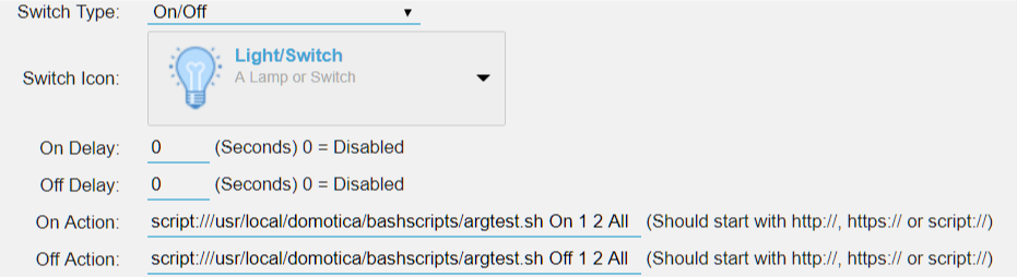

I wrote a simple script to control my foscam cameras motion. However there are plenty of commands available and I have two cameras of that type, so I tried to do it all in one script. As arguments I'm passing camera number and command number, it is simple and works from executing from the shell via eg. "./camera.sh 1 6"
However when I try to run it from switch using :
2018-10-14 23_03_23-Window.png (1.79 KiB) Viewed 5059 times
I'm getting fault:
2018-10-14 22:51:29.739 Error: Error executing script command (/home/pi/domoticz/scripts/camera.sh). returned: 256
When I modify my script and remove the arguments, then running script via simple "script://camera.sh" works fine.
Is there a way to trigger scripts from switch selector with passed arguments? I could make a workaround and create like 15 different scripts doing same thing just with different camera and different command, but I hope it's possible to make it in "cleaner" way:) I've spend last hour to figure/find that out, so any help will be much appreciated:)

Garreth wrote: Sunday 14 October 2018 23:06 Hello,
I'm getting fault:
This should work with arguments.
bashscript:
#!/bin/bash
echo $(date) $@ >> /usr/local/domotica/data/test
output after some tests
Sun 14 Oct 23:56:09 CEST 2018 On 1 2 All
Sun 14 Oct 23:56:13 CEST 2018 Off 1 2 All
Sun 14 Oct 23:56:16 CEST 2018 On 1 2 All
according to this 256 might be a representation of 1 so maybe something funny is going on in your script. Is domoticz running with the same user as your test from the CLI ?

waaren wrote: Monday 15 October 2018 0:10 This should work with arguments.
Wow, kudos to you my friend!
Full path followed by script:/// (three slashes) did the trick :)
And 256 could be, because I have condition to "exit 1" when parameters are not within limits. But thats not so important to focus on that value I guess.

Garreth wrote: Monday 15 October 2018 16:47
I had the same error message but it was due to writing to a log file that was created by user pi :S, after removing the file and let the script create a new one it was from user root. ==> solved.
