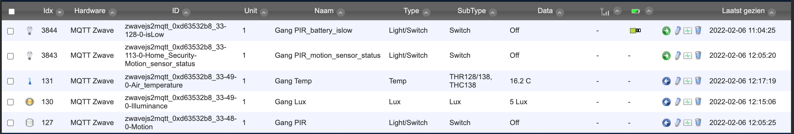

Good afternoon all,
Since some days after working for years I noticed delay of 3-7 seconds on battery operated Zwave PIR sensors and Zwave Door/Window contact not registering all updates. I noticed in the OZW logfile the command came in on the right time, but only 5 seconds later I was able to see it in Domoticz. I reinstalled Domoticz and restored my db backup, still the same delay.
Thanks to this topic I discovered a new way of setting up Zwave instead of the OZW plugin for Domoticz, so I was hoping this would solve the delay and other problems. I migrated all devices to Zwavejs2mqtt, and they are auto discovered in Domoticz and I replaced them. But, unfortunately there is no improvement and the delay is still the same.
Any idea what to do? Could the USB stick itself be faulty? Or any idea what to try before replacing it?
As you can see in the screenshot below, Gang PIR_motion_sensor_status seems to change status 5 seconds earlier then Gang PIR. So might the problem be in Domoticz after all? I don't think so, because Zigbee and 433 PIR's react very fast like normal.
Thanks.
Thanks.

Re: MQTT Audo-discovery
Did you check the mqtt message received at that time and do they show the same delay?

Thanks for your reply!jvdz wrote: Sunday 06 February 2022 13:27 Did you check the mqtt message received at that time and do they show the same delay?
Yes, indeed I see 4 seconds delay also over there, please check below:
So that means to me the delay comes from within your zwave network. Maybe a faulty unit is causing this?
That's what I think also indeed.jvdz wrote: Sunday 06 February 2022 13:52 So that means to me the delay comes from within your zwave network. Maybe a faulty unit is causing this?
But the PIR in this example is connected directly to the controller and 5x Fibaro Dimmer 2 devices.
So because it's also direclty connected to the controller, I assume the controller is faulty?
The other Fibaro dimmers all work fine. Any idea how t debug this any further?
Or in case it's indeed the USB stick, can I backup the conifig and import it to the new stick in Zwavejs2mqtt? Or do I have to include them all again?
I'm very happy with the improved replace functionality in Domoticz in this case....

Ok, so please share the MQTT details so we can check what is happening:
- Which gateway & devices are giving you this issue?
- Share the Config & State update MQTT messages as described here.
- Share the domoticz log messages when the new devices are discovered/created.
Jos
Jos
