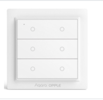

I have a Aqara Opple switch 3 bands. Every switch has more then one function. one press, double press, triple press, hold, release
Schermafbeelding 2022-02-05 om 13.54.49.png (42.85 KiB) Viewed 1128 times
How to configure every button as switch on and switch off

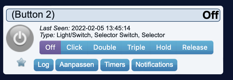

Schermafbeelding 2022-02-05 om 13.58.43.png (89.04 KiB) Viewed 1128 times

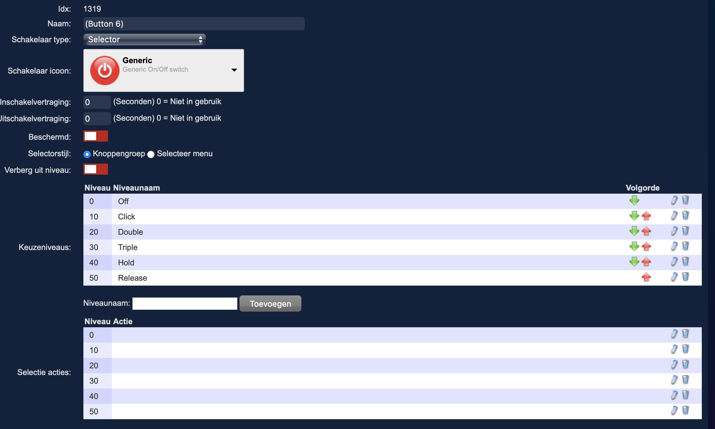

Schermafbeelding 2022-02-05 om 13.57.40.png (369.13 KiB) Viewed 1128 times
Posts: 7021
Domoticz version: 2026.3
Re: Aqara Opple switch 3 bands how configure in Domoticz with Blockly
Make a blockly script that checks the state and do the on/off action for another device according that state.
So something like
If level button 2 is "Click" set switch x on
If level button 2 is "Double" set switch x off
Since latest stable it is also possible to toggle a switch on/off.
If level button 2 is "Click" set switch x toggle.
