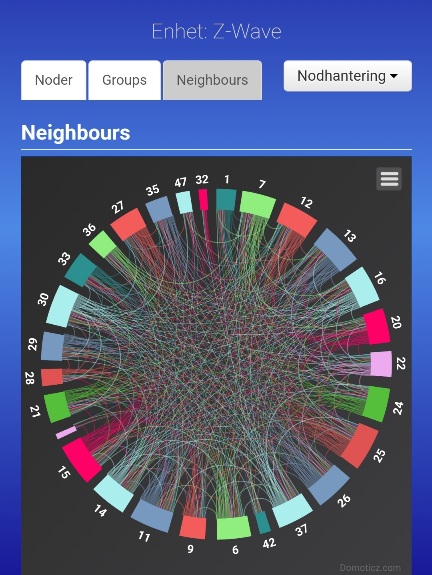

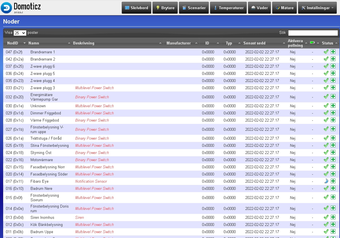

Maybe i have range problems.
The controller cant connect to all the nods. Picture from old raspberry pi 2.
Screenshot_20220203-010751_Samsung Internet.jpg (76.38 KiB) Viewed 1230 times
Screenshot_20220203-010726_Samsung Internet.jpg (92.95 KiB) Viewed 1230 times
