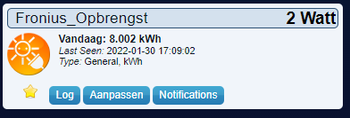

I also changed another few things but basically it is doing the same.
I'am not completely happy with the devicetype of the 3 energy devices. It is showing Watt instead of Wh as a unit. I think a custom sensor as device type is better.
I also used some user variables for the IP addresses. Debug is done a little bit different.

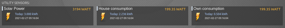

Hi, I also wanted to share my script which I improved to cover my expectations. It was initially found in the "photovoltaikforum". User Gerhard told me that he got great support here; so credit to Gerhard and thanks to all who helped him.
I have also added the Own consumption measurement. This is supposed to count just what I consume from self-production. Important for that sensor is that the energy is "computed" based on the power. I have added a side note on the sensor creation string.
   local IPFronius = '192.168.178.34'         -- IP adress of the Fronius converter
   local idx_PV = 68                -- idx of the virtual sensor, you need to change this to your own Device IDx
   local idx_VERBRAUCH = 71               -- idx of PowerMeter (Energy provider supply)
   local idx_EIGENVERBRAUCH = 69          -- idx of Eigenverbrauch (House consumption W and computed KWh)
   local idx_PEIGENVERBRAUCH = 70          -- idx of PEigenverbrauch (House consumption own consumed W and computed KWh)

      --Extract data from Fronius converter.
      froniusurl   = 'curl "http://'..IPFronius..'/solar_api/v1/GetInverterRealtimeData.cgi?Scope=Device&DeviceID=1&DataCollection=CommonInverterData"'
      jsondata    = assert(io.popen(froniusurl))
      froniusdevice = jsondata:read('*all')
      jsondata:close()
      froniusdata = JSON:decode(froniusdevice)
      -- extract data from Fronius Power Meter 63A
      froniusurl2   = 'curl "http://'..IPFronius..'/solar_api/v1/GetMeterRealtimeData.cgi?Scope=System"'
      jsondata2    = assert(io.popen(froniusurl2))
      froniusdevice2 = jsondata2:read('*all')
      jsondata2:close()
      froniusdata2 = JSON:decode(froniusdevice2)
      --Process fronius data
      if (froniusdata ~= nil) then
      local StatusCode       = froniusdata['Body']['Data']['DeviceStatus']['StatusCode']
         if( StatusCode == 7) then --Fronius converter is Running
           local DAY_ENERGY   = froniusdata['Body']['Data']['TOTAL_ENERGY']['Value']
           local PAC          = froniusdata['Body']['Data']['PAC']['Value']
           local VERBRAUCH    = froniusdata2['Body']['Data']['0']['PowerReal_P_Sum']
           local EIGENVERBRAUCH = VERBRAUCH + PAC
           if VERBRAUCH < 0 then
           MYEIGENVERBRAUCH = EIGENVERBRAUCH
           elseif VERBRAUCH > 0 then
           MYEIGENVERBRAUCH = PAC
           local PEIGENVERBRAUCH = MYEIGENVERBRAUCH
           commandArray[1] = {['UpdateDevice'] = idx_PV .. "|0|" .. PAC .. ";" .. DAY_ENERGY}
           commandArray[2] = {['UpdateDevice'] = idx_VERBRAUCH .. "|0|" .. VERBRAUCH }
           commandArray[3] = {['UpdateDevice'] = idx_EIGENVERBRAUCH .. "|0|" .. EIGENVERBRAUCH }
           commandArray[4] = {['UpdateDevice'] = idx_PEIGENVERBRAUCH .. "|0|" .. PEIGENVERBRAUCH }
           local PAC=0
           local PEIGENVERBRAUCH = 0
           commandArray[3] = {['UpdateDevice'] = idx_EIGENVERBRAUCH .. "|0|" .. VERBRAUCH }
--      tprint(commandArray)
   return commandArray[attachment=0]Selfconsumed.png[/attachment]

-- Script to read solardata from FroniusAPI
-- Original Autor : Meulderg  http://www.domoticz.com/forum/viewtopic.php?t=15037#p119999
-- Changed to dzVents by glsf91
-- Date : 14-03-2021
-- This script needs to be placed in the /home/pi/domoticz/scripts/dzVents/scripts/ directory
-- Warning: Don't forget to setup the Local Networks otherwize the device counters won't get updated if site security is used.
    active = true,
	logging = {
    	--level = domoticz.LOG_DEBUG, -- Uncomment to override the dzVents global logging setting and use debug
    	marker = 'Fronius'
      timer = {
         'every minute'
      httpResponses = { 'triggerFronius' }
   execute = function(domoticz,item)
       	-- Variables to customize ------------------------------------------------
	      --Create Virtual Hardware via JSON script, dubble click the URL after changing the requred settings. The Virtual hardware is then automaticly created.
    	    --Change IP, Port and name accordingly
    	    --http://192.168.1.4:8080/json.htm?type=command&param=addhardware&htype=15&port=1&name=Fronius&enabled=true
    	--Create Virtual sensors via JSON script, dubble click the URL after changing the requred settings. The Virtual hardware is then automaticly created.
    	  --Change IP, Port and idx (idx is of the previously created hardware ID) accordingly
    	  --http://192.168.1.4:8080/json.htm?type=createvirtualsensor&idx=2&sensorname=Fronius_Opbrengst&sensortype=18
    		--Above sensor needs to be manual adjusted to Type: Return. (Open the device and edit the type).
		--For these sensors below create a virtual sensor manualy. Sensor type = Custom sensor.
        --Fronius_Day_Energy with label 'kW'
    	--Fronius_Year_Energy with label 'kW'
    	--Fronius_Total_Energy with label 'MW'
		--The Virtual sensors below can be used, but if not delete them from the rest of the script also
    	--http://192.168.1.4:8080/json.htm?type=createvirtualsensor&idx=2&sensorname=Fronius_UAC&sensortype=4
    	--http://192.168.1.4:8080/json.htm?type=createvirtualsensor&idx=2&sensorname=Fronius_UDC&sensortype=4
    	--http://192.168.1.4:8080/json.htm?type=createvirtualsensor&idx=2&sensorname=Fronius_IAC&sensortype=19
    	--http://192.168.1.4:8080/json.htm?type=createvirtualsensor&idx=2&sensorname=Fronius_IDC&sensortype=19
	   -- If you change the names of the sensor, also change it below
    	local IPdomiticz = domoticz.variables('UV_DomoticzIP').value    -- Set this value in Domoticz as User Variable "String" -> IP adress of the domoticz service + port
    	local IPFronius = domoticz.variables('UV_FroniusIP').value		-- Set this value in Domoticz as User Variable "String" -> IP adress of the Fronius converter
    	local idx_Fronius_Opbrengst = domoticz.devices('Fronius_Opbrengst').idx

After (I think) a firmware update of the Fronius device, I get these errors:
2022-01-30 10:34:00.275 Error: dzVents: Error: (3.1.8) Fronius: Fronius inverter head status code data is not 0
2022-01-30 10:34:00.275 Error: dzVents: Error: (3.1.8) Fronius: An error occurred when calling event handler Fronius
2022-01-30 10:34:00.275 Error: dzVents: Error: (3.1.8) Fronius: ...n/domoticz/scripts/dzVents/generated_scripts/Fronius.lua:102: attempt to perform arithmetic on a string value
After turning on debug:
2022-01-30 10:39:00.376 Status: dzVents: Debug: Fronius: Callback from url requested
2022-01-30 10:39:00.376 Status: dzVents: Debug: Fronius: Data: {
2022-01-30 10:39:00.376 "Body" : {
2022-01-30 10:39:00.376 "Data" : {}
2022-01-30 10:39:00.376 },
2022-01-30 10:39:00.376 "Head" : {
2022-01-30 10:39:00.376 "RequestArguments" : {
2022-01-30 10:39:00.376 "DataCollection" : "CommonInverterData",
2022-01-30 10:39:00.376 "DeviceClass" : "Inverter",
2022-01-30 10:39:00.376 "Scope" : "Device"
2022-01-30 10:39:00.376 "Status" : {
2022-01-30 10:39:00.376 "Code" : 6,
2022-01-30 10:39:00.376 "Reason" : "CGI-Args: Invalid parameter '' for attribute 'DeviceId' (must be numeric)",
2022-01-30 10:39:00.376 "UserMessage" : ""
2022-01-30 10:39:00.376 "Timestamp" : "2022-01-30T10:38:57+01:00"
2022-01-30 10:39:00.376 Status: dzVents: Info: Fronius: ------ Finished Fronius
Where to start looking?
glsf91
Posts: 58
Joined: Tuesday 14 November 2017 21:56
Re: Solved: Problem with LUA script reading from Fronius inverter
Post by glsf91 »
SterkeJerke wrote: Sunday 30 January 2022 10:37 2022-01-30 10:39:00.376 "Reason" : "CGI-Args: Invalid parameter '' for attribute 'DeviceId' (must be numeric)",
This is the problem. Look at my post a few above yours. It is caused by a firmware update.
Search for DeviceID and change to DeviceId. It is in the url sended to Fronius inverter.
SterkeJerke
Posts: 18
Joined: Friday 01 February 2019 20:57
Post by SterkeJerke »
Wow Thanks! That solved it.
Had the device and installed and upadated in december, so did not think that would be relavent.

How would I set the "Fronius_Opbrengst" to 0 in the part after sunset/before sunrise?
Schermafbeelding 2022-01-30 180759.png (14.86 KiB) Viewed 1803 times

SterkeJerke wrote: Sunday 30 January 2022 18:09 How would I set the "Fronius_Opbrengst" to 0 in the part after sunset/before sunrise?
Do something like this after "domoticz.log('Sunset in minutes: ' ..timeofday['SunsetInMinutes'] + 60, domoticz.LOG_DEBUG)":
-- set day energie to 0 at start of day
if (minutes_now == 5) then
domoticz.log('Set day energy to zero at start of day', domoticz.LOG_INFO)
domoticz.openURL('http://'..IPdomiticz..'/json.htm?type=command&param=udevice&idx='..idx_Fronius_Opbrengst..'&nvalue=0&svalue=0;0')
This will run at 00:05

HAd the bright idea to put it behind:
SterkeJerke
Posts: 18
domoticz.log('Fronius inverter Offline because of SunSet', domoticz.LOG_INFO)
Is there a way, to not override the last value? Or something like:
domoticz.openURL('http://'..IPdomiticz..'/json.htm?type=command&param=udevice&idx='..idx_Fronius_Opbrengst..'&nvalue=0&svalue=0;'..DAY_ENERGY)
glsf91
Posts: 58
Post by glsf91 »
Get the current value of day energie and use this as last value.
domoticz.devices('Fronius_Total_Energy').counterToday
