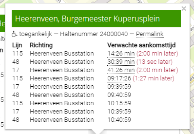

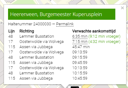

I have the next block in my config.js but it shows the busses in one direction instead of all directions.
This busstop have 2 tpc codes => 24000030 and 24000040 but shows only 24000030 in the specified block.
Can you fixed that?

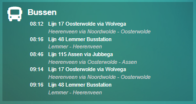

This is the actual Dashticz output with the above block: I expect bus station is one direction, Oosterwolde is the other direction.brandsrus wrote: Monday 24 January 2022 12:16 I have the next block in my config.js but it shows the busses in one direction instead of all directions.
This busstop have 2 tpc codes => 24000030 and 24000040 but shows only 24000030 in the specified block.Code: Select all
blocks['ovapi'] = { station: 'HrKup', //utrlun, Amstel: 60094 title:'Bussen', show_lastupdate:true, provider: 'ovapi', show_via: true, icon: 'fas fa-bus', results: 5 };
Can you fixed that?
Correct?
I can add a linedirectionnumber (1 or 2) to the output of the Dashticz block if that would be useful.

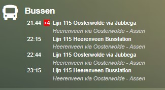

That is not the situation around 12.00 CET, there are more lines on both stops and then it's shows only the direction of Oosterwolde.Lokonli wrote: Monday 24 January 2022 21:54This is the actual Dashticz output with the above block:brandsrus wrote: Monday 24 January 2022 12:16 I have the next block in my config.js but it shows the busses in one direction instead of all directions.
Can you fixed that?
Correct?

The information from ovzoeker: And the view on Dashticz block:brandsrus wrote: Monday 24 January 2022 22:50That is not the situation around 12.00 CET, there are more lines on both stops and then it's shows only the direction of Oosterwolde.Lokonli wrote: Monday 24 January 2022 21:54This is the actual Dashticz output with the above block:brandsrus wrote: Monday 24 January 2022 12:16 I have the next block in my config.js but it shows the busses in one direction instead of all directions.
Can you fixed that?
Correct?
All busses to Heerenveen Busstation are missing.

De funny thing is, this is my output:
That means including Heerenveen ...
Can you update to latest version (git pull): I've fixed two small things yesterday evening (although I don't think it's related to this)
Increase the results block parameter
Double check that you are really using 'ovapi' in your column definition, and that you don't redefine the 'ovapi' block.
(I have show_via set to false. That explains why each second line is not visible ...)
brandsrus
- Posts: 20
- Joined: Wednesday 27 October 2021 14:13
Re: Dashticz - v3.8.10 beta
If you increase the results to 10 then it works!
ANy value between 5 and 10 it don't work and you see de busses in one direction.
I try an other busstop and i need a value of 15 if all stops will present in Dashticz.
