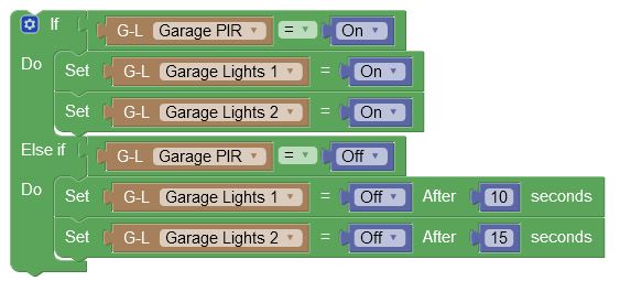

Does anyone have any suggestions as to why this would happen.
I have a 433Mhz PIR in my garage that connects to Domoticz via an RFXCOM, I have a simple blockly that says if the PIR is On (triggered) turn on both garage light switches. if the PIR is Off turn the first switch Off after 120 seconds and the second switch Off after 130 seconds, I have to assume as it has always worked ok that each time the PIR triggers the countdown timmer resets because as long as I kept moving the lights never went off. The 10 second difference was so that if I stopped moving for 2 mins I wasn't plunged into darkness and had 10 secs to wave my hand around to retrigger the lights.
All of a sudden my lights fail to turn off, they still come on when I go in but never turn off unless i do it manually either with the switch (dual wifi switch) or via the web interface. I've tried deleting the blockly completely and recreating it and rebooting the RPi that Domoticz is on but no different. I've changed the time in the blockly as you can see for testing purposes but it just doesn't work anymore.
Help !
