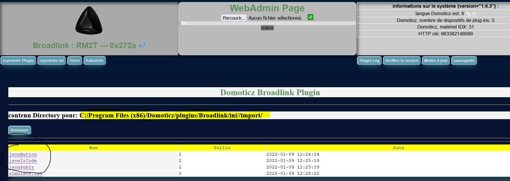

Thank you, what’s my domoticzplugin/import directory ? You mentioned android in your reply, am i missing something ?

when you install the Broadlink plugin, severals directories should be created under your domoticz plugin directory, "import" should be one if them.DrMacabre wrote: Sunday 09 January 2022 12:47 Thank you, what’s my domoticzplugin/import directory ? You mentioned android in your reply, am i missing something ?
Yep, android for tasks that need to be done on your android phone.

Re: Python Plugin : Broadlink
Ok so i was doing it right but the import dir wasn’t created during the installation of the plugin though, i had to do it manually and all 3 json files are in it but nothing ever happened after i clicked the econtrol button on the web interface. Do you think this might be an issue due to ownership attributes of the json files or something ?
yes .. can be.
this is the directory structure for the import process (windows):
Oh ok, i see, that’s Broadlink/ini/import/ not Broadlink/import/ that’s why.

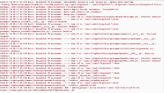

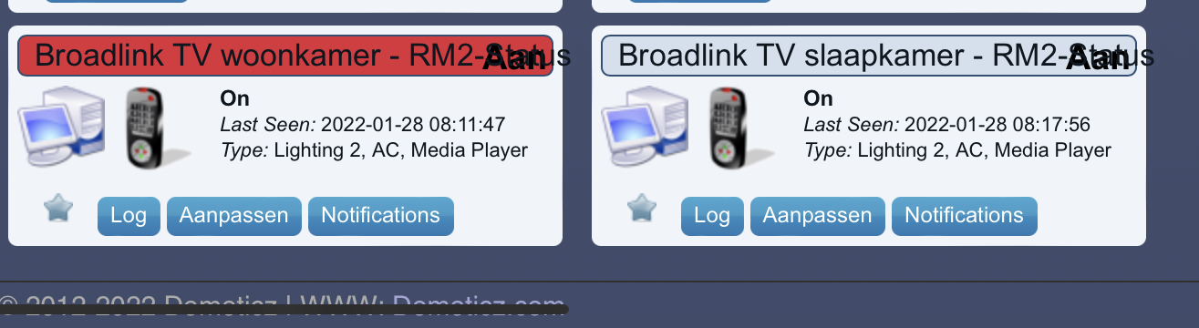

I have installed the Broadlink plugin on my Raspberry Pi.
All is working ok in Domoticz to control my tvs.
Only after a reboot I always get always the attached error and always have to deactivate and activate the broadlink hardware to avoid the device shows Red.
How to get rid of this message ?
- 3CFF57C2-D78D-408D-8DBB-5F73064DE594.png (89.25 KiB) Viewed 3501 times
- EBCBBD96-5DBA-455B-9D24-9AF9E9BEA59E.jpeg (325.52 KiB) Viewed 3501 times

Sorry, but your screenshot is not 'readable'.
provide full text log.

In problem log after a reboot and a domoticz stop and start
2022-01-28 08:17:40.233 Error: Broadlink TV woonkamer: (Broadlink) failed to load 'plugin.py', Python Path used was '/home/pi/domoticz/plugins/Broadlink/:/usr/lib/python37.zip:/usr/lib/python3.7:/usr/lib/python3.7/lib-dynload:/usr/local/lib/python3.7/dist-packages:/usr/lib/python3/dist-packages:/usr/lib/python3.7/dist-packages'.
2022-01-28 08:17:40.233 Error: Broadlink TV woonkamer: Module Import failed, exception: 'InternalError'
2022-01-28 08:17:40.233 Error: Broadlink TV woonkamer: Error Line details not available.
2022-01-28 08:17:40.233 Error: Broadlink TV woonkamer: Exception traceback:
2022-01-28 08:17:40.233 Error: Broadlink TV woonkamer: ----> Line 129 in '/home/pi/domoticz/plugins/Broadlink/plugin.py', function <module>
2022-01-28 08:17:40.233 Error: Broadlink TV woonkamer: ----> Line 12 in '/usr/local/lib/python3.7/dist-packages/requests_toolbelt/__init__.py', function <module>
2022-01-28 08:17:40.233 Error: Broadlink TV woonkamer: ----> Line 12 in '/usr/local/lib/python3.7/dist-packages/requests_toolbelt/adapters/__init__.py', function <module>
2022-01-28 08:17:40.233 Error: Broadlink TV woonkamer: ----> Line 12 in '/usr/local/lib/python3.7/dist-packages/requests_toolbelt/adapters/ssl.py', function <module>
2022-01-28 08:17:40.233 Error: Broadlink TV woonkamer: ----> Line 55 in '/usr/lib/python3/dist-packages/requests/__init__.py', function <module>
2022-01-28 08:17:40.233 Error: Broadlink TV woonkamer: ----> Line 59 in '/usr/lib/python3/dist-packages/requests/packages/__init__.py', function <module>
2022-01-28 08:17:40.233 Error: Broadlink TV woonkamer: ----> Line 49 in '/usr/lib/python3/dist-packages/requests/packages/__init__.py', function vendored
2022-01-28 08:17:40.233 Error: Broadlink TV woonkamer: ----> Line 47 in '/usr/lib/python3/dist-packages/urllib3/contrib/pyopenssl.py', function <module>
2022-01-28 08:17:40.233 Error: Broadlink TV woonkamer: ----> Line 8 in '/usr/lib/python3/dist-packages/OpenSSL/__init__.py', function <module>
2022-01-28 08:17:40.233 Error: Broadlink TV woonkamer: ----> Line 12 in '/usr/lib/python3/dist-packages/OpenSSL/rand.py', function <module>
2022-01-28 08:17:40.233 Error: Broadlink TV woonkamer: ----> Line 6 in '/usr/lib/python3/dist-packages/OpenSSL/_util.py', function <module>
2022-01-28 08:17:40.233 Error: Broadlink TV woonkamer: ----> Line 195 in '/usr/local/lib/python3.7/dist-packages/cryptography/hazmat/bindings/openssl/binding.py', function <module>
2022-01-28 08:17:40.233 Error: Broadlink TV woonkamer: ----> Line 151 in '/usr/local/lib/python3.7/dist-packages/cryptography/hazmat/bindings/openssl/binding.py', function init_static_locks
2022-01-28 08:17:40.233 Error: Broadlink TV woonkamer: ----> Line 134 in '/usr/local/lib/python3.7/dist-packages/cryptography/hazmat/bindings/openssl/binding.py', function _ensure_ffi_initialized
2022-01-28 08:17:40.233 Error: Broadlink TV woonkamer: ----> Line 120 in '/usr/local/lib/python3.7/dist-packages/cryptography/hazmat/bindings/openssl/binding.py', function _register_osrandom_engine
2022-01-28 08:17:40.233 Error: Broadlink TV woonkamer: ----> Line 78 in '/usr/local/lib/python3.7/dist-packages/cryptography/hazmat/bindings/openssl/binding.py', function _openssl_assert
