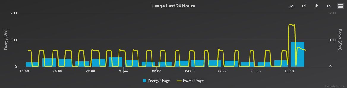

I purchased a KP115 in Australia (AU$29) and can confirm it is operating perfectly and exactly as per the HS110. It's quite a bit smaller, about the size of a typical USB charger.
In this case I'm using the plugin. I have it on long term test measuring my fridge power usage.
