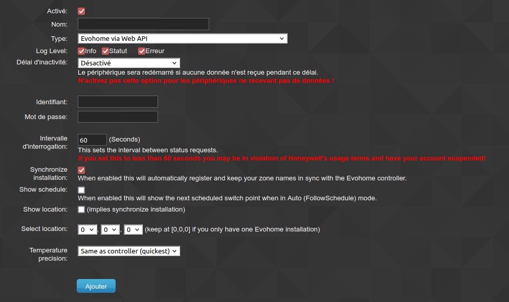

Hello everyone,
I would to know if it is possibile to add explanation between parameters like for the Evohome via web API :
Sans titre.png (108.52 KiB) Viewed 1938 times
I looked at differents plugin github repositories but none of them has description integrated between each parameters. They all have the wiki code with only the label :

Hi keros,
You can't in the current Domoticz stable but I liked this idea so I just pushed an update into the beta channel that allows it:

the description is shown above the parameter and can contain embedded HTML so it can be styled
