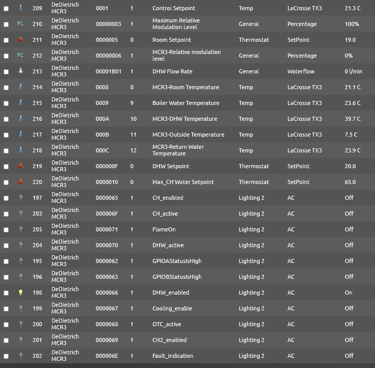

boe666
Posts: 47
Joined: Thursday 19 January 2017 16:14
Re: HomeHabit Dashboard - Updates
Post by boe666 »
igor wrote: Wednesday 06 October 2021 3:38
boe666 wrote: Friday 01 October 2021 16:02 What types of variables are suitable for the homehabit thermostat module? Apart from the temperatures and the modules for setting them, i.e.
Mode, FAN, STATE.
There is no mapping for thermostat fan/mode for Domoticz currently.
What kind of thermostat device you have integrated with Domoticz?
I use OpenTherm Gateway. Domoticz have many particular devices (see attachment). But homehabit see only "temperature" and "termostat" variables.
2021-11-02 23_06_46-Domoticz — Mozilla Firefox.png (56.67 KiB) Viewed 7258 times
