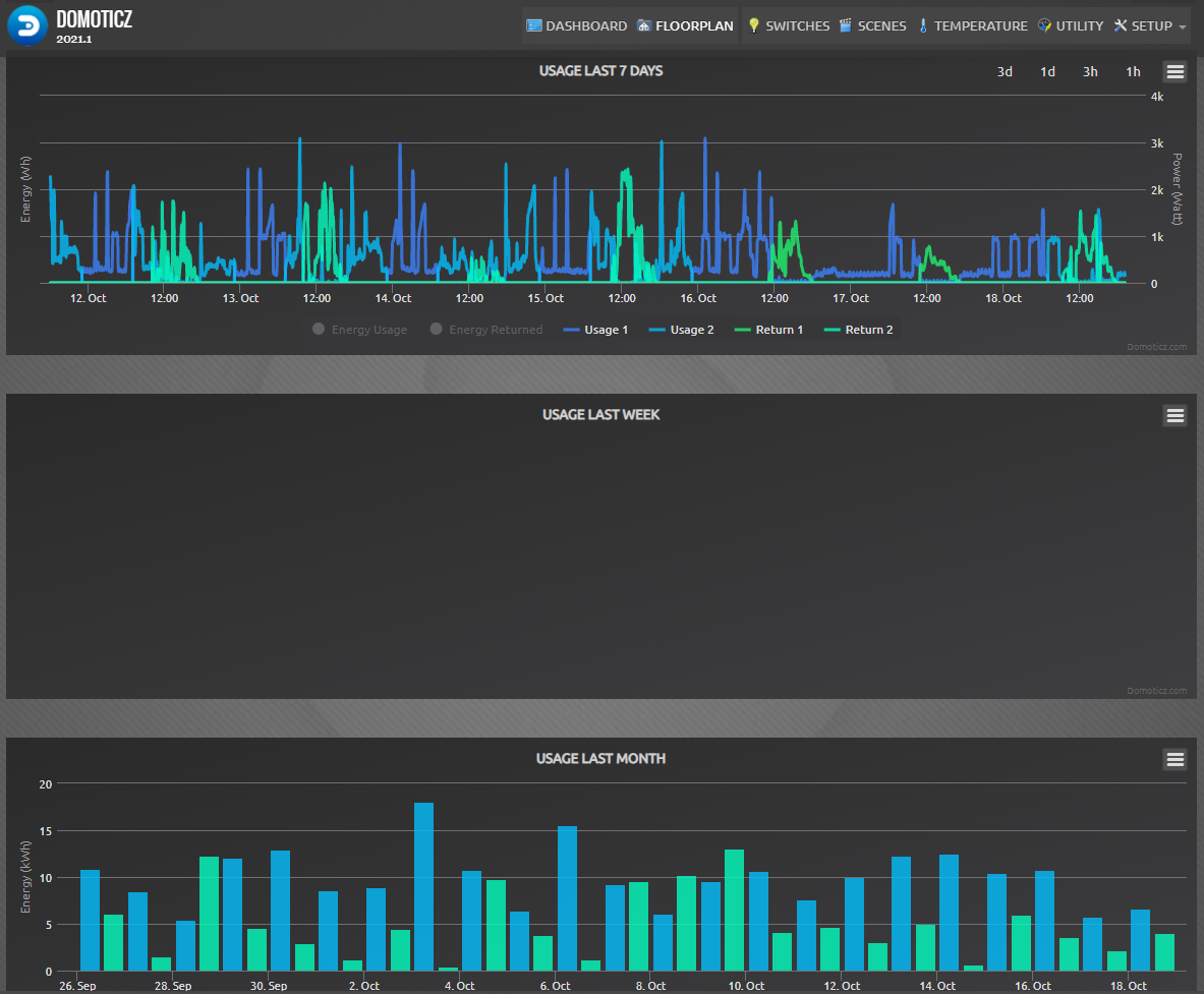

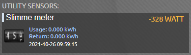

Last week the P1 meter stopped showing the history.
I have no idea why.
Values are still getting in, and as far as I can tell they are correct.
I also see the history before the 18th, but not after the 18th of oct at 19:10 it seems like it just stopped logging.
Tile showing actual value:
The history not showing after 18th:
Any ideas what could be the issue here?
I have no idea why.

CRTL+F5 and manually cleared cache, not solved.waltervl wrote: Tuesday 26 October 2021 15:32 Clear browser cache. Use CTRL-F5 first See also wiki page.
What theme are you on? Try to change to default theme.
I use "dark-th3me" and switching to default did not solve the issue.

If you click on the menu icon in the empty graph, can you download the CSV file and do you get the expected values?

last rows of CSV for "usage last 7 days":
"2021-10-18 17:50:00";0;0;0;0
"2021-10-18 17:55:00";0;12;0;0
"2021-10-18 18:00:00";0;132;0;0
"2021-10-18 18:05:00";0;216;0;0
"2021-10-18 18:10:00";0;156;0;0
"2021-10-18 18:15:00";0;144;0;0
"2021-10-18 18:20:00";0;168;0;0
"2021-10-18 18:25:00";0;144;0;0
"2021-10-18 18:30:00";0;228;0;0
"2021-10-18 18:35:00";0;180;0;0
"2021-10-18 18:40:00";0;168;0;0
"2021-10-18 18:45:00";0;168;0;0
"2021-10-18 18:50:00";0;168;0;0
"2021-10-18 18:55:00";0;156;0;0
"2021-10-18 19:00:00";0;156;0;0
"2021-10-18 19:05:00";0;228;0;0
"2021-10-18 19:10:00";0;156;0;0
CSV for "usage last week" is as empty as the graph.
