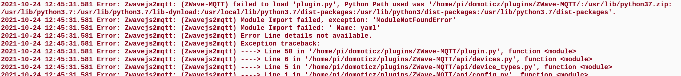

error plugin
error plugin
Schermafdruk van 2021-10-24 12-52-36.png (165.15 KiB) Viewed 2621 times
Because I started to have more and more issues with my Danfoss thermostats for heating (they remained open becasue z-wave did not send commands to them anymore until a reboot , again and again) I started to play with this zwave project.
Looks nice, and I have the gui running in docker like described on the github page.
However I cannot get the plugin to work.
I did the git pull, requirments in the dir and all is installed. When starting the plugin the following errors come:
Can someone help me out? I see this error also in the topics but I cannot get it fixed.

Think i found the issue.
On the github page it says "pip3 install -r requirements.txt" but after using "sudo pip3 install -r requirements.txt" my issue was gone.
