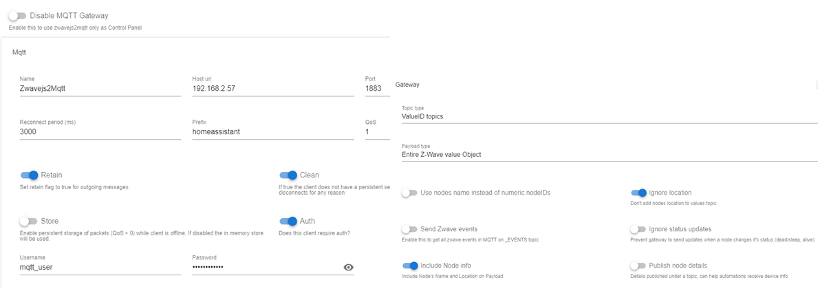

Settings in the GUI are :
BROM_08 2021-10-11 15.20.gif (33.87 KiB) Viewed 2308 times
Under : Z-Wave : I have my /dev/ttyUSB-ZWAVE to my USB stick and under "S0 Legacy" my key I used under OZW
Under : Home Assistant : I have selected MQTT Discovery I tried it also with WS Server or both
Do I have to do also something in Domoticz what do I forget or wrong?
How is autodiscovery working under Domoticz?

@jvdz the same as with mosquitto_sub depends on what I select in the GUI under Gateway.
Are my settings ok, have set my prefix to homeassistant? Maybe it has to be Domoticz/homeassistant or something else?
heggink
Posts: 988
Domoticz version: 12451
Re: zwavejs2mqtt
Post by heggink »
I have payload type as JSON Time-Value.
You also want to switch retain off since that will keep the last message in the mqtt broker (so old message will continue to exist after you deleted a device recrearting that device until you manually delete the message).
your autodiscovery prefix can be anything as long as you use the same in domoticz and zwavejs. I would just use something like homeassistant or zwaveauto or ...

First mistake I made was that you you have to fill in the Auto Discovery Prefix: under Hardware and MQTT client setup in my example I use : zwave

How and when Domoticz detects something is really depending on what you fill in in the Zwavejs GUI tried several options but it doesn't look better.

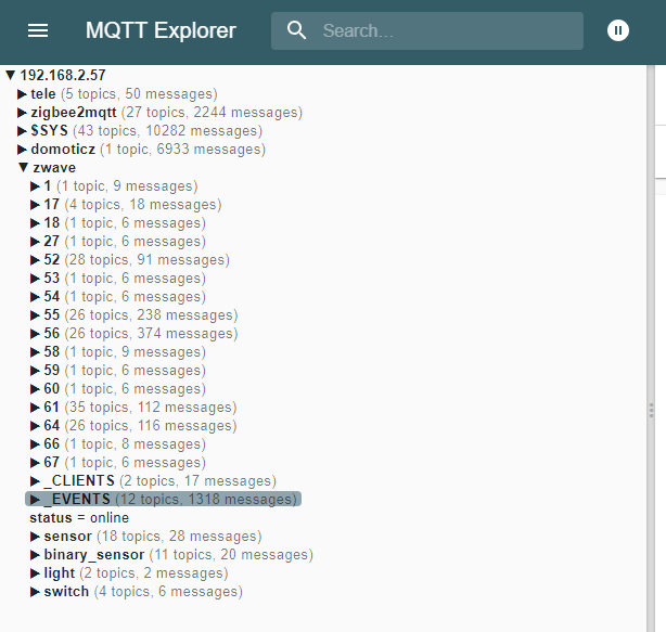

I installed MQTT-explorer it is still confusing how it works

In the Zwavejs2MQTT GUI still a lot off zwave devices not recognized like an "Fibaro FGMS001 ZW5 motion sensor" and still showen as unknown product after 2 hours of collecting.
What do I have to set On and what do I have to set OFF in the GUI of zwavejs2mqtt?
It is working but not workable.
No plugin installed because I am using 2021.1 build 13689 I think?

Are your autodiscovery prefix and mqtt prefix different? They cannot be the same as that would create issues.
If you find that some devices are not working then best to report these through either GitHub or slack (better). There is a specific channel on slack to report these. Let me know if I should send you an invitation.

In terms of the zwavejs2mqtt settings, if you use the exact same settings as defined in the python plugin then everything should be fine. Zwavejs2mqtt has tremendous support for devices, probably better than OZW.
