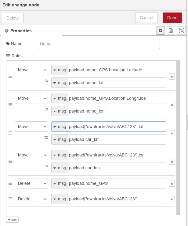

The two different sets of co-ordinates (Home and Car) are joined and parsed in the next "Change" node.

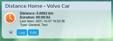

The result is as follows (for a car at home):
