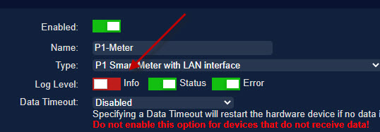

to disable these messages, switch off info logging in the hardware tab
like this

erem wrote: Friday 24 September 2021 12:27 to disable these messages, switch off info logging in the hardware tab
like this
This is what I was looking for but I do not see the option. Has this been recently added? I’m using a 2020.2 build.

Post by erem »
@eelco
yes, this is new in the last stable (2021.1).
worth the upgrade, IMHO
