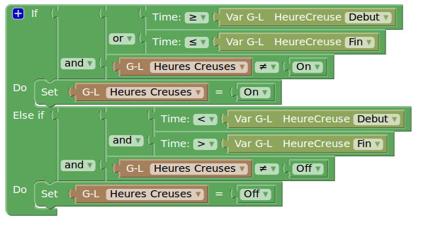

I have created two "user variables" in Domoticz of type time (one for start, the other one for stop time) named "HeureCreuse Debut" and "HeureCreuse Fin".
I created a simple blocky event which check if the current time is between or outside of the [start-stop] period and trigger a corresponding dummy switch named "HeureCreuse".
This doesn't works and I get the following error in the log :
2014-12-14 14:15:11 Error: Lua script error (Blockly), Name: HeureCreuse_var_1 => [string "result = 0; weekday = os.date('*t')['wday']; ..."]:1: unexpected symbol near 'or'
2014-12-14 14:15:11 Error: Lua script error (Blockly), Name: HeureCreuse_var_2 => [string "result = 0; weekday = os.date('*t')['wday']; ..."]:1: unexpected symbol near 'and'
In the blocky event, when I change the user variables to blocky time constants, the event works perfectly (this constant-based version controls my electric water heated since about 1 year now).
A screenshot of my blocky event is attached to this post.
Any ideas ?

If 'HeureCreuse FIN' is later than 'HeureCreuse Debut' it will always be on. I guess the or must be and.

You could use integer variables and store the times as unixtimestamp ;)

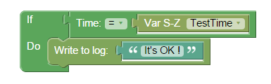

I'm not using user definied time var's but the build-in blocky timer stuff. But also this does not work. I'm using latest Domoticz on NAS Synology.
Any ideas? As work around I'm using LUA.
