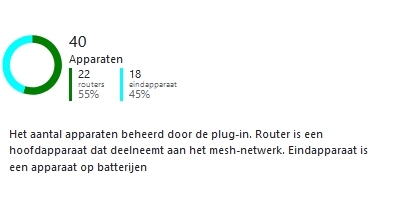

On the other side, I see 40 devices connected to the ZiGate and you might be at the limit
Is there a limit... is there a way to get more devices?
Posts: 7002
Domoticz version: 2026.3
Re: zigate tuya siren
The official limit is 40 directly and 30 extra when connected with a router. Mine was full way earlier (32 devices) due to some kind of poor memory management. I updated to firmware 31e and now I have 34 devices connected without issues.

waltervl wrote: Sunday 04 July 2021 10:46 The official limit is 40 directly and 30 extra when connected with a router. Mine was full way earlier (32 devices) due to some kind of poor memory management. I updated to firmware 31e and now I have 34 devices connected without issues.
Is there a way to expand that to more devices?
pipiche
Posts: 2034
Post by pipiche »
there is the 31e OptiPDM version , but would required a full Erase EEPROM and Erase PDM so you'll have to repair all your devices
