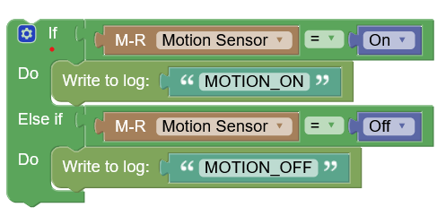

I am trying to configure a flood light to switch on after motion is detected. Attached a simple Blockly to test the motion sensor by writing a message to the log.
The motion sensor 'switch' does change state when motion is detected. Alarm events are recorded in the log.
2021-06-06 21:55:50.538 Status: Z-Wave Controller: OpenZWave: Alarm received (Home Security: Motion Detected at Unknown Location), NodeID: 22 (0x16)
However, I can't get the Blockly script to respond to motion detected and write to the log. Any ideas?

- Blockly Motion Sensor.png (25.7 KiB) Viewed 870 times

Maybe you should add another statement, If motion sensor is off and lampke is off
Do write to log motion on
I think it should use it like this, for me it works with this sensor.
My Blocky for the toilet sensor:
