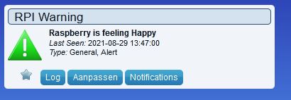

- paste it in the events under Dzvents-Timer
- Create an Alert sensor and note the IDX
- change the 'Alertidx = 4106' into 'Alertidx = [yourIDX]'
Hopefully your Raspberry Pi is a happy one :-)

    if ( AlertT == '') then
        AlertT = 'Raspberry is feeling Happy'
    -- Set the Alert Sensor
    dz.devices(Alertidx).updateAlertSensor(AlertL, AlertT)

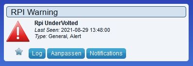

@Multinet
I think you are in troubles.....
0x50005 means you are currently under-voltage and throttled.
I have updated the script in the first post. Please replace the old one with this and let me know.
Also please change your powersupply!

What does it means throttled ?
To my understanding ( in your situation ) while voltage is under required, the speed of the PRI is throttled ( reduced/slowed down)
So if you fix your power , you will have a 'faster' PRI.

Re: Raspberry Pi internal status Dzvents script
Post by freijn »
solarboy wrote: Sunday 29 August 2021 21:37 Hi Freijn..
The output is "throttled=0x80000"
Hope this helps...Raspberry pi 3b if that helps.
If you have made a 1 to 1 copy the only issue I can see is the version of DzVents.
I need more time to investigate. sorry..
Frank
