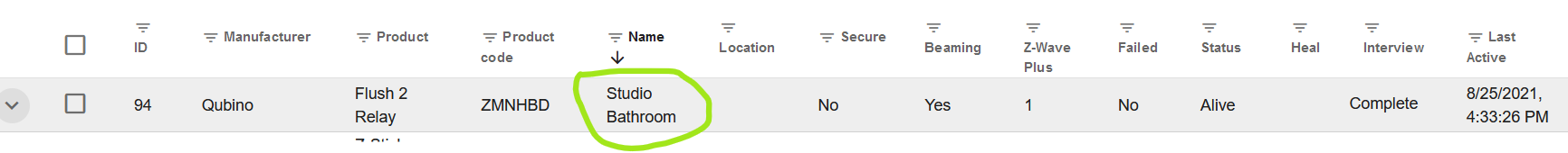

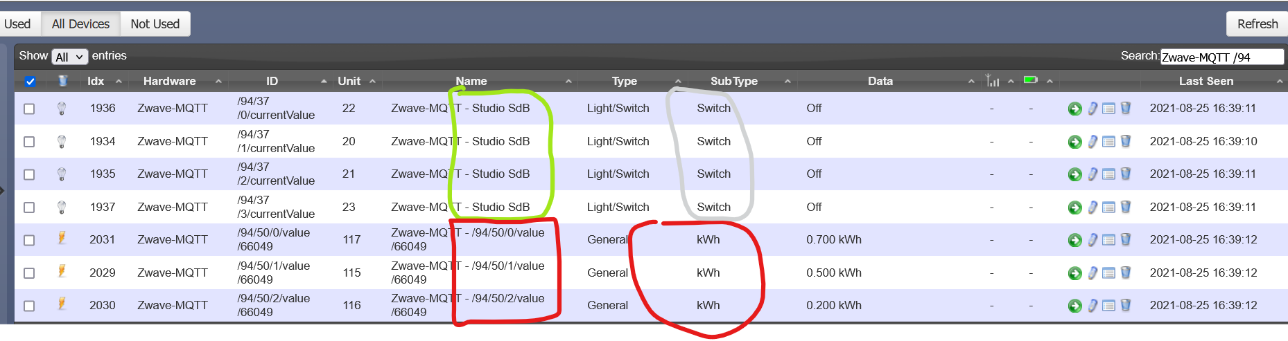

In which way does it work? I've set a name for a node in the control panel (ZWave To MQTT) and it didn't arrive in domoticz. Do I have to do somethings?
Where are located the ZWave To MQTT data (and other stuff). To backup them...
The best way is to, before you install the plugin, name all your devices in zwavejs2mqtt. They will all then be created with that name in domoticz. I would need to check myself what happens if you change the name of an existing device in zwavejs2mqtt. Don't know really.
I've set a name in zwavejs2mqtt
I've disabled the plugin in dz and removed all the zwavejs2mqtt devices
I've enabled the plugin in dz
The name show up in the devices list for some devices of the node (switches, but no kWh)
After I change the name in zwavejs2mqtt and redo the process, and the names didn't change in dz (I think it is good because the initial names have to be changed)

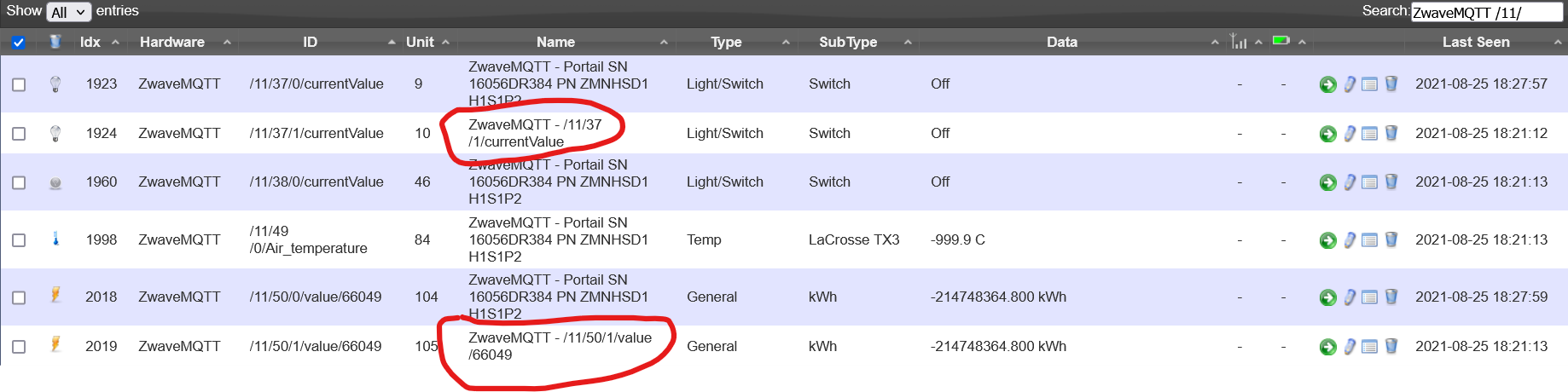

Screenshot 2021-08-25 182854.png (104.33 KiB) Viewed 2647 times
So I did it
37 nodes => 143 devices => 15 devices with bad names for 9 nodes
The bad nodes are not in specifics Type or SubType, but looks random

Yes!
in the picture just above (18:34) some devices are created without the name set in zwavejs2mqtt.
It's
Screenshot 2021-08-25 182854.png (104.33 KiB) Viewed 2645 times
"random" because for a node, some devices are ok and others are ko
Also, possible to remove the "ZwaveMQTT" from the device name, not very user friendly

hestia wrote: Wednesday 25 August 2021 18:46 Yes!
It's Screenshot 2021-08-25 182854.png"random" because for a node, some devices are ok and others are ko
Right, so some devices get created correctly using the name in zwavejs but some are not?
Please file a bug on the plugin github page. What would help is that you enable full debugging and also list what device this is together with the device screen from zwavejs2mqtt. As mentioned previously, we have a bunch of devices that are already correct but there may well be the odd one here and there that may not work correctly. ALl bugs are tracked through github.
In terms of removing the plugin name from the device name, please file that separately as an enhancement and we'll look into that as well.
Outside of that, things working OK?
