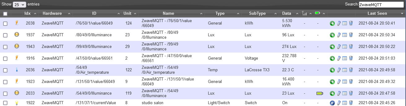

I needed some time to find the node in dz... So, I understand that I'm going to have new devices... and I don't know how I'm going to match them with the old ones...
It's seems that I'll need to redo the dz part (names, plans, scripts (with idx). I just have 80 devices used, so it's possible. Maybe, I missed something on this part....
