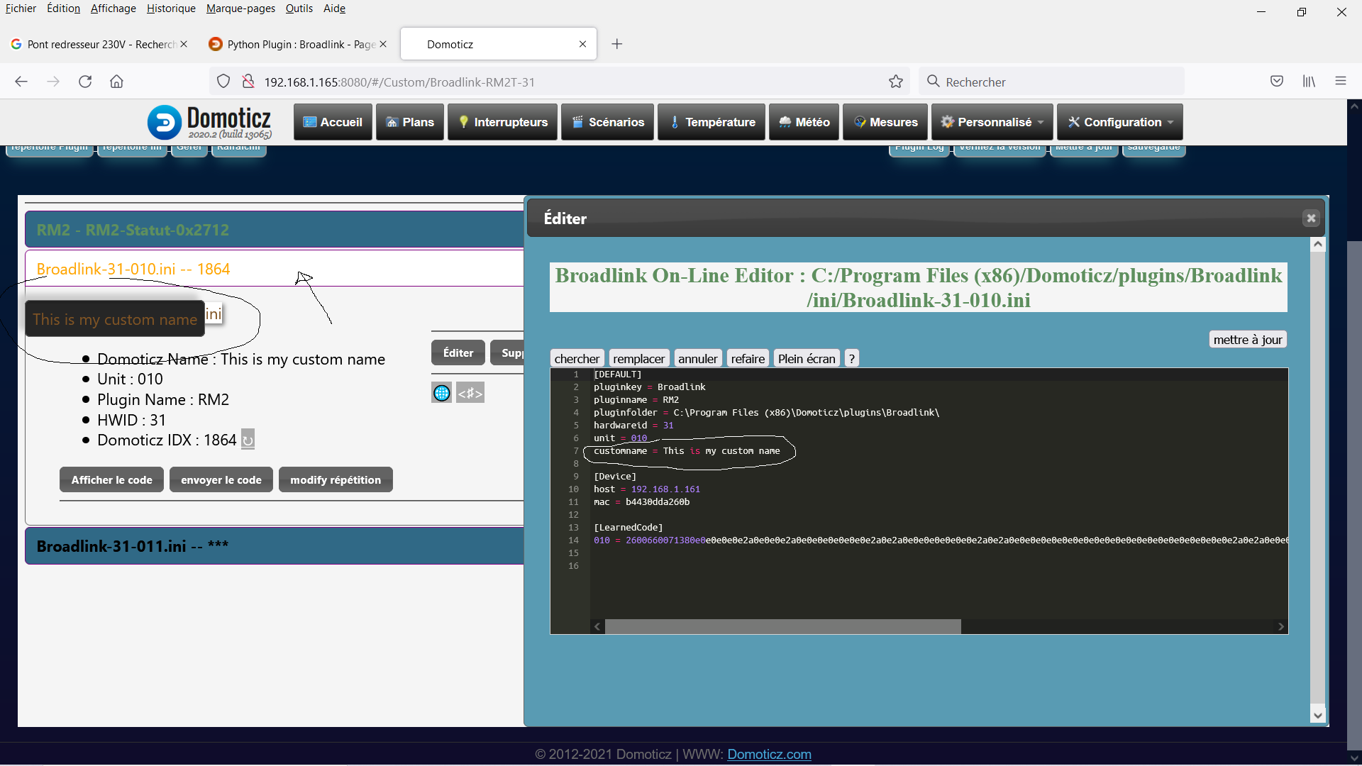

zak45
Posts: 954
Domoticz version: V2024.4
Re: Python Plugin : Broadlink
Post by zak45 »
extremeaudio wrote: Friday 16 July 2021 17:32 I have learnt all the IR that I want to learn on one domoticz installation. Now I want to move it to another installation without learning again.
How do I move the learnt IR codes? And I how do I link those codes to the switches that I will create in the new installation?
Lastly, is there a way to have some meaningful names for the ini files instead of the Broadlink-1-7.ini like SonyTV-OK.ini or something?
Copy the ini files from old to new under the ini/import folder e.g. : C:\Program Files (x86)\Domoticz\plugins\Broadlink\/ini/import/
and click on the import button.
Once imported, choose one ini and click on create device, be sure to have enabled 'new device creation' on Domoticz settings.
The ini file name could not be changed but you can put custom name inside the ini file e.g.

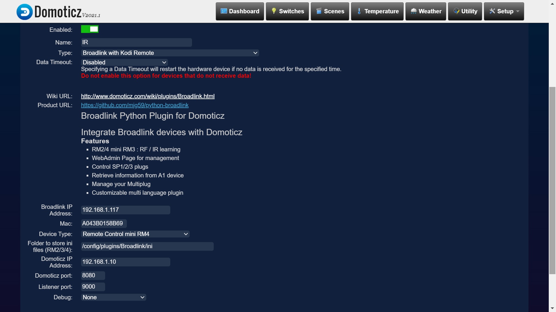

I am using this with domoticz docker on coreelec. I have installed the plugin successfully. But when I add the hardware I get an error in log as below
Error: (Broadlink) failed to load 'plugin.py', Python Path used was '/config/plugins/Broadlink/:/usr/lib/python37.zip:/usr/lib/python3.7:/usr/lib/python3.7/lib-dynload:/usr/lib/python3.7/site-packages'.

As mentioned, using the linuxserver docker version of domoticz in portainer.
After creating hardware now there is no mention whatsoever in the logs of any broadlink activity, neither errors nor successful devvice creation, nor are the switches created within domoticz

extremeaudio wrote: Saturday 17 July 2021 18:55 I am using this with domoticz docker on coreelec. I have installed the plugin successfully. But when I add the hardware I get an error in log as below
which is correctly an error because the python path on my system is not at
but at
/storage/.kodi/userdata/domoticz/plugins/Broadlink
What file do I need to edit to replace this path?
EDIT:
On second thoughts, I can see that in docker my volume /config is mapped to the /storage/.kodi/userdata/domoticz
then shouldnt it work?
This seems to be an issue very similar to mine. Anyone have any idea how to resolve this when using the docker container of domoticz?
https://github.com/stas-demydiuk/domoti ... /issues/16
extremeaudio
Posts: 47
Joined: Tuesday 24 November 2020 17:57
Post by extremeaudio »
Any tips on how to use this plugin when using domoticz docker please?
No matter what I try I get errors saying
2021-07-26 21:24:04.980 Error: IR: (Broadlink) failed to load 'plugin.py', Python Path used was '/opt/domoticz/userdata/plugins/Broadlink/:/usr/lib/python37.zip:/usr/lib/python3.7:/usr/lib/python3.7/lib-dynload:/usr/local/lib/python3.7/dist-packages:/usr/lib/python3/dist-packages:/usr/lib/python3.7/dist-packages'.
2021-07-26 21:24:04.980 Error: IR: (IR) Module Import failed, exception: 'ModuleNotFoundError'
2021-07-26 21:24:04.980 Error: IR: (IR) Module Import failed: ' Name: broadlink'
2021-07-26 21:24:04.980 Error: IR: (IR) Error Line details not available.
