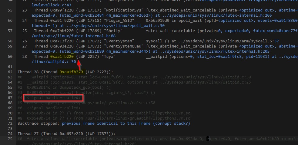

The Tuya plugin makes my system unstable and crashes Domoticz about two-three times a day. Any clue what can cause this?
Posts: 6683
Domoticz version: 2025.1
Re: Python Plugin: TUYA
loeknl wrote: Monday 23 August 2021 22:56 The Tuya plugin makes my system unstable and crashes Domoticz about two-three times a day. Any clue what can cause this?
Stable or Beta release of Domoticz?
loeknl
Posts: 6
Joined: Saturday 04 July 2020 16:16
Domoticz version: 2021.1

waltervl wrote: Tuesday 24 August 2021 9:16 Stable or Beta release of Domoticz?
I use the stable 2021.1 From april 17h
And the up to date Tuya plugin (1.0.12)
Posts: 6683
It could be related to another python plugin. Disable them one by one and see if the crash will disappear.
That is strange I never had any issue when the plug-in is running.
This is a good tip.
waltervl wrote: Wednesday 25 August 2021 15:50 It could be related to another python plugin. Disable them one by one and see if the crash will disappear.
