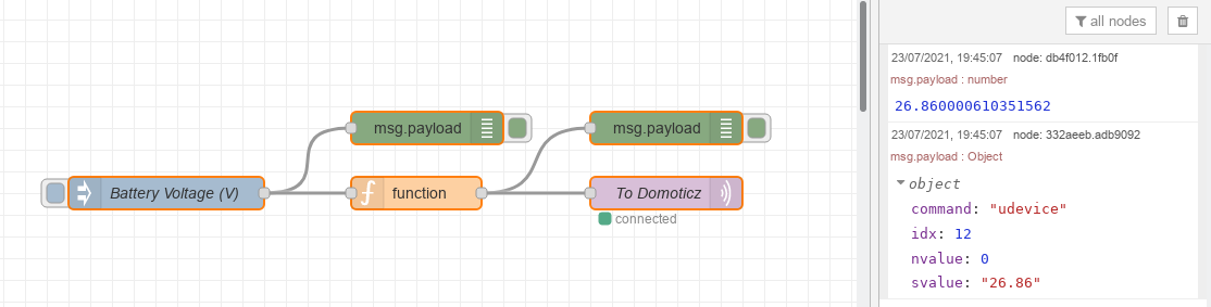

It presents the Voltage with 15 (!) digits after the decimal point. I suggest that we reduce this to 2 digits.
Otherwise it will not look nice in the Domoticz widget.

2. Drag and drop a "Function" node to the canvas and connect the input of the "Function" to the output of the "Victron" node.
The contents of the "Function"node is as follows:
msg.payload = {"command":"udevice","idx":12,"nvalue":0,"svalue":msg.payload.toFixed(2).toString()};
return msg;
The elements in this object are:
- "command":"udevice" ; This is a default value and may be left out.
- "idx":12; This is the IDX of the device, you created previously. Change it to your device number.
- "nvalue":0; Just for completeness. May be removed.
- "svalue":msg.payload.toFixed(2).toString(); The important part.
Function toFixed(2) is responsible for 2 digits after the decimal point. You can change the number, if you want more or less digits.
Function toString() converts the numerical value to the string value.

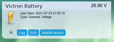

This will result in Domoticz to:

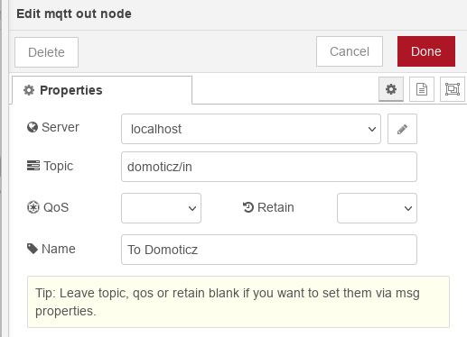

You have to configure your MQTT out node to your settings (It depends on which one, you use)
The message should be published to domoticz/in
Please find the complete flow (excluding the Inject node) below:
[{"id":"db4f012.1fb0f","type":"debug","z":"4137f1f8.cf269","name":"","active":true,"tosidebar":true,"console":false,"tostatus":false,"complete":"false","statusVal":"","statusType":"auto","x":1010,"y":120,"wires":[]},{"id":"16dc3c48.4c0c1c","type":"function","z":"4137f1f8.cf269","name":"","func":"msg.payload = {\"command\":\"udevice\",\"idx\":12,\"nvalue\":0,\"svalue\":msg.payload.toFixed(2).toString()};\nreturn msg;","outputs":1,"noerr":0,"initialize":"","finalize":"","libs":[],"x":1000,"y":180,"wires":[["332aeeb.adb9092","f803b251.5c6ff8"]]},{"id":"332aeeb.adb9092","type":"debug","z":"4137f1f8.cf269","name":"","active":true,"tosidebar":true,"console":false,"tostatus":false,"complete":"false","statusVal":"","statusType":"auto","x":1230,"y":120,"wires":[]},{"id":"f803b251.5c6ff8","type":"mqtt out","z":"4137f1f8.cf269","name":"To Domoticz","topic":"domoticz/in","qos":"","retain":"","respTopic":"","contentType":"","userProps":"","correl":"","expiry":"","broker":"f9f13036.e28b58","x":1230,"y":180,"wires":[]},{"id":"f9f13036.e28b58","type":"mqtt-broker","name":"localhost","broker":"127.0.0.1","port":"1883","clientid":"","usetls":false,"compatmode":true,"keepalive":"60","cleansession":true,"birthTopic":"","birthQos":"0","birthRetain":"false","birthPayload":"","closeTopic":"","closeQos":"0","closePayload":"","willTopic":"","willQos":"0","willPayload":""}]
If everything is functioning correct remove the (green) debug nodes.

So here is how is it looking what I needed in Domoticz:
And here is the flow in NodeRed:

Here is Node Red flow I used for my setup:
https://1drv.ms/u/s!AshuXSMP155fgaZQji1 ... w?e=dgf3Jk
And picture:
In Domoticz I have just created another MQTT gateway pointing to Raspberry with Venus OS and couple of dummy devices which IDX have to be set in each "function" module in Node Red.
And at last, this is how is it looking on my dashboard:
With this setup I could easily interact on state of charge of my battery and solar charger output. For example I could switch some of my solar panels to water heater in case there is no battery drain and connect it back on demand, charge secondary battery for my electric scooter etc. It works really great.
