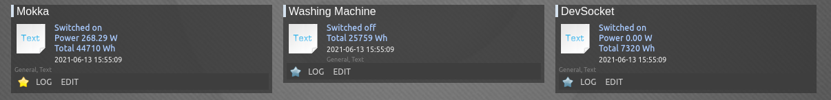

Re: AVM DECT200 - switch / domiticz on raspberry
Hello, I also use a couple of DECT 200 and wanted status and consumption as well as total energy. I initially used sensors to display but now headed over to multiline text. You need the following (I put all in my domoticz/scripts folder) and make sure all references to files are in the absolute path:
1. Script to get connected DECT200 written to a txt file; at the end, you find a link to python script to then write all into JSON format; my filename was avm.sh (make sure you have it executable chmod +x avm.sh):
2. Script to write data into JSON format (my filename was DECT200.py):
3. Lua event in Domoticz; I kept a lot of other code since it required debugging on the way. I am not an expert and hope somebody of you can make this code much smarter. I used sensors which I now don't. I decided to stay with text driven based on the status. If switched on, I will show status, current power and total energy - if switched off, status and total energy.

-- lua script
-- mokka plug
-- local idx_2_power = xx
-- local idx_2_energy = xx
local idx_2_state = 31
-- washining machines
-- local idx_6_power = xx
-- local idx_6_energy = xx
local idx_6_state = 34
-- devsocket
local idx_7_state = 35
os.execute('/home/domoticz/scripts/avm.sh')
json = (loadfile "/home/domoticz/scripts/lua/JSON.lua")() -- For Linux
-- API call
local config=assert(io.popen('curl "file:///home/domoticz/scripts/DECT200.json"'))
local Stringjson = config:read('*all')
config:close()
local jsonData = json:decode(Stringjson)
-- local name2 = jsonData.Switch2['Switch Name']
-- local AIN2 = jsonData.Switch2['AIN']
-- local connected2 = jsonData.Switch2['Connected']
local state2 = jsonData.Switch2['State']
local temperature2 = jsonData.Switch2['Temperature']
local power2 = jsonData.Switch2['Current Power']
local energy2 = jsonData.Switch2['Total Energy']
-- local name6 = jsonData.Switch6['Switch Name']
-- local AIN6 = jsonData.Switch6['AIN']
-- local connected6 = jsonData.Switch6['Connected']
local state6 = jsonData.Switch6['State']
local temperature6 = jsonData.Switch6['Temperature']
local power6 = jsonData.Switch6['Current Power']
local energy6 = jsonData.Switch6['Total Energy']
-- local name7 = jsonData.Switch7['Switch Name']
-- local AIN7 = jsonData.Switch7['AIN']
-- local connected7 = jsonData.Switch7['Connected']
local state7 = jsonData.Switch7['State']
local temperature7 = jsonData.Switch7['Temperature']
local power7 = jsonData.Switch7['Current Power']
local energy7 = jsonData.Switch7['Total Energy']
--print (state2)
local state2num = tonumber(state2)
local state6num = tonumber(state6)
local state7num = tonumber(state7)
if state2num == 0 then
state2txt = 'Switched off'..'\r\n'..'Total '..energy2 ..' Wh'
elseif state2num == 1 then
state2txt = 'Switched on'..'\r\n'..'Power '..power2 ..' W\r\n'..'Total '..energy2 ..' Wh'
if state6num == 0 then
state6txt = 'Switched off'..'\r\n'..'Total '..energy6 ..' Wh'
elseif state6num == 1 then
state6txt = 'Switched on'..'\r\n'..'Power '..power6 ..' W\r\n'..'Total '..energy6 ..' Wh'
if state7num == 0 then
state7txt = 'Switched off'..'\r\n'..'Total '..energy7 ..' Wh'
elseif state7num == 1 then
state7txt = 'Switched on'..'\r\n'..'Power '..power7 ..' W\r\n'..'Total '..energy7 ..' Wh'
--print (state2txt)
--print (Stringjson) -- debug json
--print ('Name '..Name) -- parsed json value
--print ('AIN '..AIN) -- parsed json value
--print ('Connected '..Connected) -- parsed json value
--print ('State '..State) -- parsed json value
--print ('Temperature '..Temperature..' C') -- parsed json value
--print ('Current Power '..CurrentPower..' W') -- parsed json value
--print ('Total Energy '..TotalEnergy..' Wh') -- parsed json value
--energy2kwh = math.ceil(energy2 / 1000)
--energy6kwh = math.ceil(energy6 / 1000)
--commandArray[#commandArray + 1] = {['UpdateDevice']= idx_2_power .. "|0|" .. power2 .. ";" .. energy2}
--commandArray[#commandArray + 1] = {['UpdateDevice']= idx_2_energy .. "|0|" .. energy2}
commandArray[#commandArray + 1] = {['UpdateDevice']= idx_2_state .. "|0|" .. state2txt}
--commandArray[#commandArray + 1] = {['UpdateDevice']= idx_6_power .. "|0|" .. power6 .. ";" .. energy6}
--commandArray[#commandArray + 1] = {['UpdateDevice']= idx_6_energy .. "|0|" .. energy6}
commandArray[#commandArray + 1] = {['UpdateDevice']= idx_6_state .. "|0|" .. state6txt}
commandArray[#commandArray + 1] = {['UpdateDevice']= idx_7_state .. "|0|" .. state7txt}
return commandArray- Attachments
- DECT200 Domoticz.png (80.86 KiB) Viewed 1396 times

In domoticz log file I see :
row 17: attempt to call a nil value
row 17 is:
I also create in domoticz 3 general devices with text.
But where do I put this 3 IDX numbers in wich script ?
Thanks so far

Hi, sorry, wasn't here for a while and have not received a notification on your question. Anyhow, the idx numbers are set in the lua script in Domoticz just at the beginning.
-- devsocket
