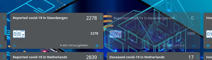

Thanks for looking at the problem, I will recreate the device. The script was not changed in a long time.
edit: Make a new counter and it is working again!?!
2021-06-08 21_38_08-Domoticz - Overige.png (245.69 KiB) Viewed 2722 times
sqlite> select * from DeviceStatus where id in (638, 835);
ID|HardwareID|DeviceID|Unit|Name|Used|Type|SubType|SwitchType|Favorite|SignalLevel|BatteryLevel|nValue|sValue|LastUpdate|Order|AddjValue|AddjMulti|AddjValue2|AddjMulti2|StrParam1|StrParam2|LastLevel|Protected|CustomImage|Description|Options|Color
638|8|82638|1|Reported covid-19 in Steenbergen old|1|113|0|3|1|12|255|0|2283|2021-05-31 15:37:41|651|0.0|1.0|0.0|1.0|||0|0|0||ValueQuantity:UGVvcGxl|
835|8|82835|1|Reported covid-19 in Steenbergen    |1|113|0|3|0|12|255|0|2278|2021-06-08 21:36:41|650|0.0|1.0|0.0|1.0|||0|0|0||ValueQuantity:UGVvcGxl|
sqlite>
