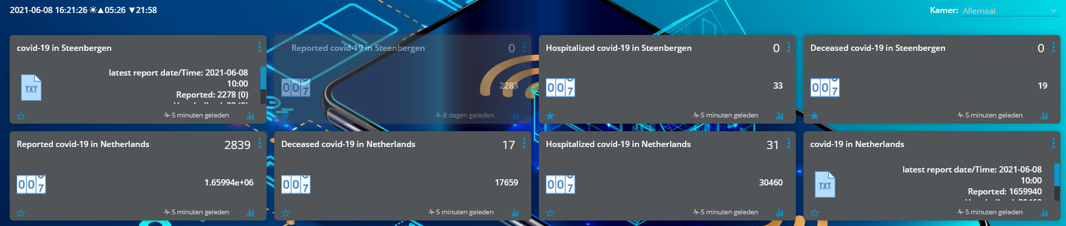

The text.device is populated! i will check later so for the total in Netherlands. Tnhx very much!
2020-08-21 13_30_39-Window.png (38.94 KiB) Viewed 4593 times
Update 14:30:
Total in Netherlands updated!
2020-08-21 14_30_22-Window.png (9.18 KiB) Viewed 4589 times

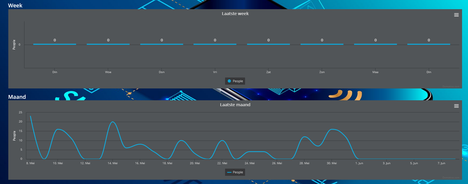

My 'Reported covid-19 in' is 7 days not updated? Do anyone have this issue to?
HP T630 (256GB SSD/8GB Mem) - Ubuntu 24.04.3 LTS (64Bit) - Domoticz 2025.2 (Docker) Machinon theme - RFLink - KaKu - Sonoff - Tasmota - Shelly - MQTT2Zigbee - OpenTherm Gateway - Tinytuya - IR Blaster - P1 Smart Meter - NPN Watermeter - Google Assistant
Re: Dutch local covid-19 figures
Xenomes wrote: Monday 07 June 2021 22:44 My 'Reported covid-19 in' is 7 days not updated? Do anyone have this issue to?
covid script is still working for me. (see below)
Do you see anything in the log?
Xenomes
Posts: 448
Joined: Tuesday 27 November 2018 19:05
Domoticz version: 2025.2
Post by Xenomes »
I change the script 2 days a go to the latest version, before that is was running for months.
In the log it show this:
2021-06-08 16:16:06.129  Status: dzVents: Info: Handling Domoticz custom event for: "CovidTrigger_checkDate"
2021-06-08 16:16:09.379  Status: dzVents: Info: Handling Domoticz custom event for: "CovidTrigger_curlReady"
2021-06-08 16:16:40.803  Status: dzVents: Info: Handling Domoticz custom event for: "CovidTrigger_jqReturn"
2021-06-08 16:16:41.271  Status: dzVents: Info: Handling Domoticz custom event for: "CovidTrigger_jqFilterReady"
2021-06-08 16:16:41.856  Status: dzVents: Info: Handling Domoticz custom event for: "CovidTrigger_updateText"
