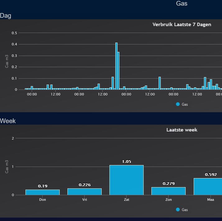

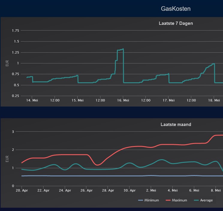

I hope to get an answer / solution to my challenge here. I read my energy consumption with a P1 module. That works. I found a script to calculate consumption to Energy costs and it works too. However, I see a line graph in the “log” of Gas costs and I would like a bar graph the same I see with my gas consumption and my power consumption.
I see this in the log of my gas costs:
But I would like to see it like this:
So with bars.
I use this script for it and will therefore have to change something somewhere, so it does shows bars instead of lines.
Who knows the answer or gives me a hint?

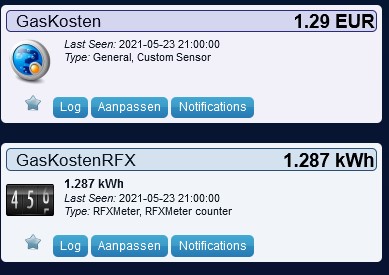

By modifing the script I came a littlebit further and now got this:
But kWh should be EUR and I have to get two decimals instead of 3 but I think I can solve that by editing the formular in the script...
Re: Energy costs in bar graph instead of line graph
HennyN wrote: Sunday 23 May 2021 21:12 But kWh should be EUR
Press the edit (aanpassen) button on the device when in the utility tab.

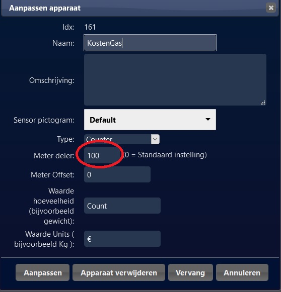

Oké. Now I have still one challenge... :(
How do I get 2 decimal place every where...
I did some testing and found that I can multiply with 100 in the script and then devide by 100 in the device..
But is there a neater way, better way to do that. :?:

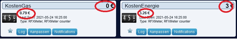

STRANGE !!!!!!

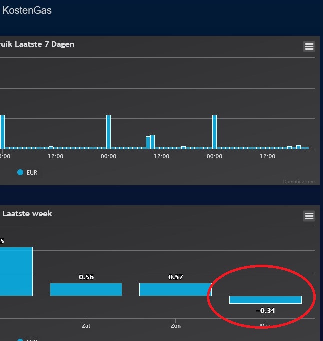

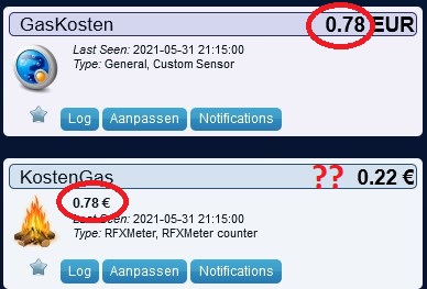

In an attempt to get column graphs of the cost of gas consumption I run into strange things. If I show the costs with a custom sensor, I get € 0.78. but when I turn it into a Counter I see € 0.78 in one place but € 0.22 in the top right (or often other values that do not match.
When I look at the log I see a negative value on today Monday.
What is going on here???? What am I doing wrong?
Rare getallen Gas.jpg (35.84 KiB) Viewed 1893 times
Instellingen Counter Gas.jpg (51.38 KiB) Viewed 1893 times
Grafiek Gaskosten.jpg (53.63 KiB) Viewed 1893 times
HennyN wrote: Monday 31 May 2021 21:43 in the top right (or often other values that do not match.
Top right corner should show (max. today value )- (max yesterday value )
