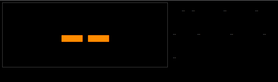

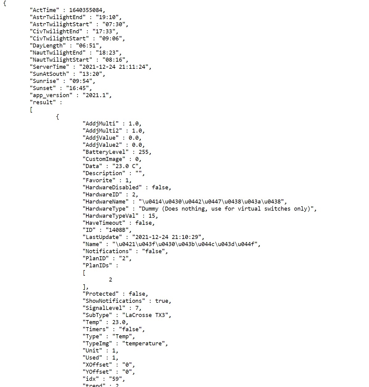

frontpage.html is not displayed correctly from domoticz.
* html on windows pc everything is shown.
* html on domoticz is not shown (see above)
On Raspberry via vnc viewer in browser:
* html is not shown (see above)
* http://mydomoticz:8080/json.htm?type=devices&plan=0 the browser shows data
Anyone have an idea what's going wrong?
Domoticzurl = hostname:8080* html on windows pc everything is shown.

Have you tried your own ip of the raspberry and is the idx set correctly ?
- Posts: 29
- Joined: Friday 29 November 2019 18:01
- Domoticz version: Stable
- Location: Gent
Found it. There was an error in the html file. Copied to Windows desktop and was also wrong view.
Now he is doing well.
