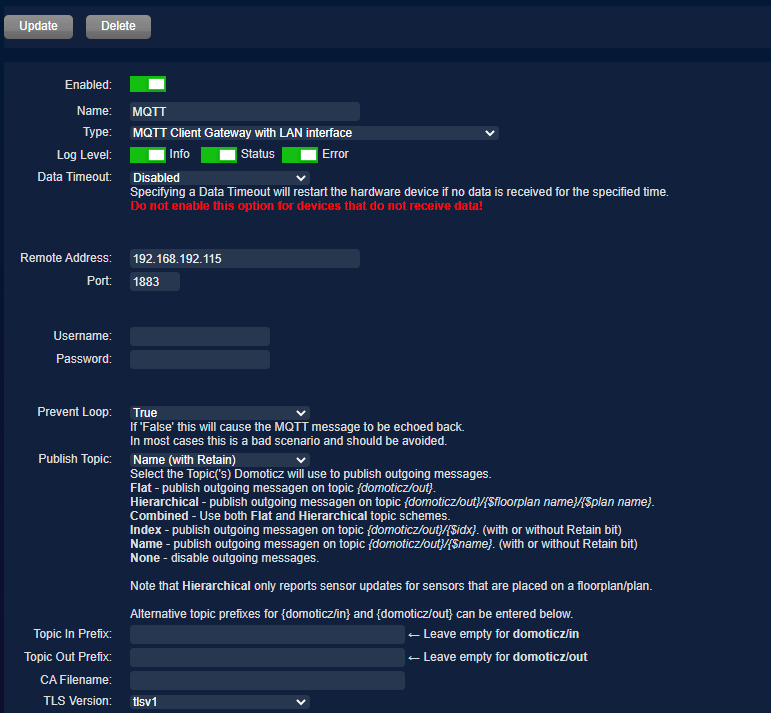

The settings page for mqtt appears to have changed a bit. This is how it looks for me
I am getting no weird message in the log either
I don't think it's due to it being a virtual sensor since I have other virtual sensors that send their value without problems. However this is the only virtual device I have that is controlled with a dzVents so maybe thats the issue?
I will try to update Domoticz tomorrow and see if that fixes it. Thanks for the help anyhow!
Edit: These are my settings https://imgur.com/FcY8njO
