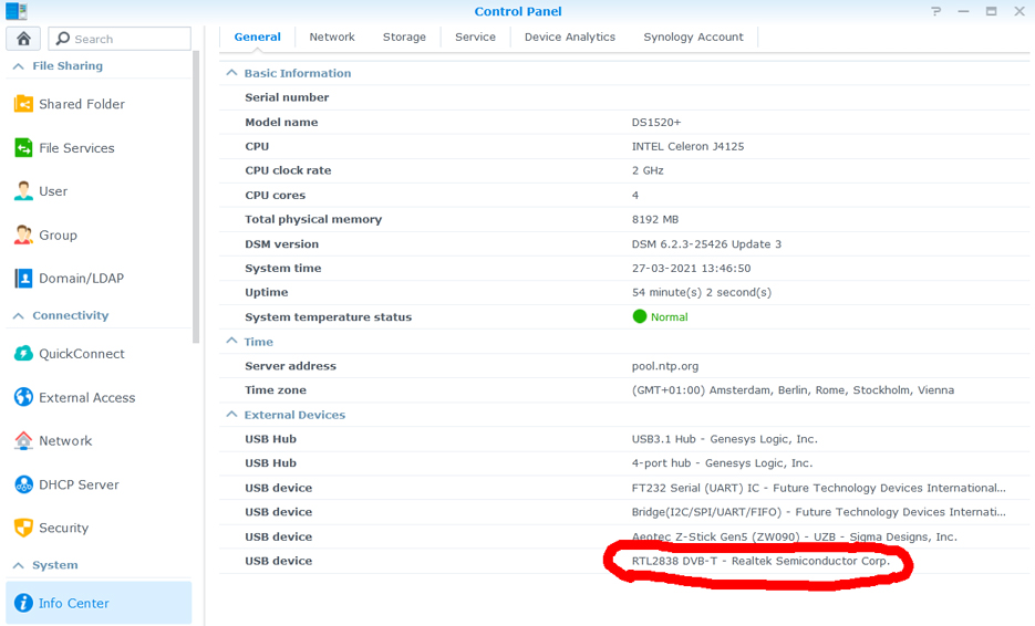

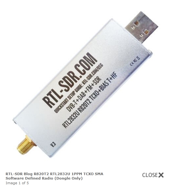

Is it correct that the RTL USB dongle does not have a USB port (see hardware screenprint)
Do I manually have to install RTL drivers?, My Synology NAS seems to recognize the RTL gongle.
Or am I doing something else wrong?

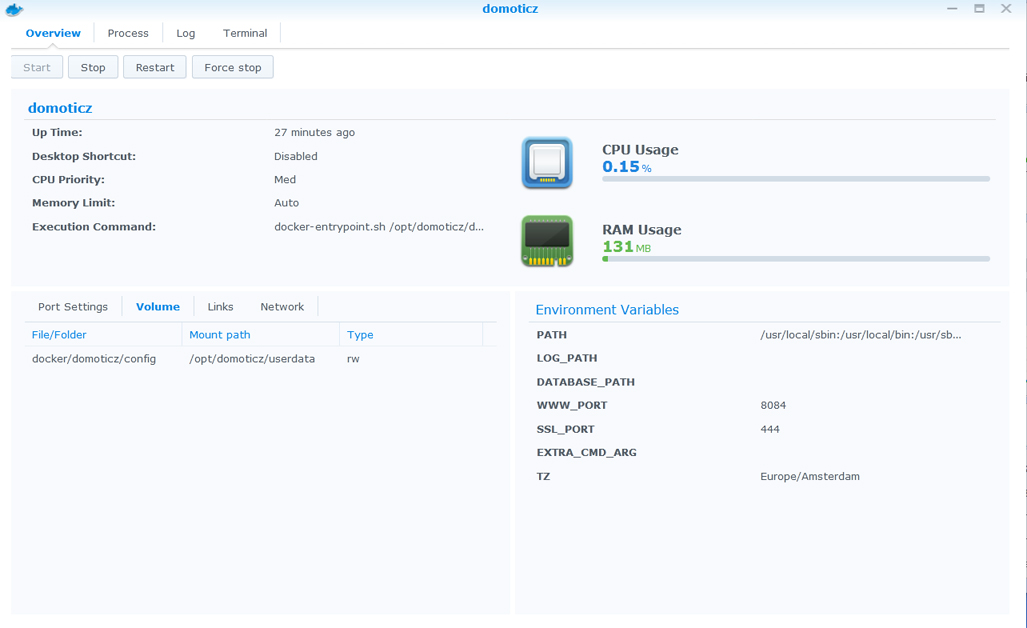

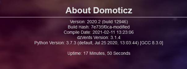

And a few more screenshots.
Hope that someone can help me.

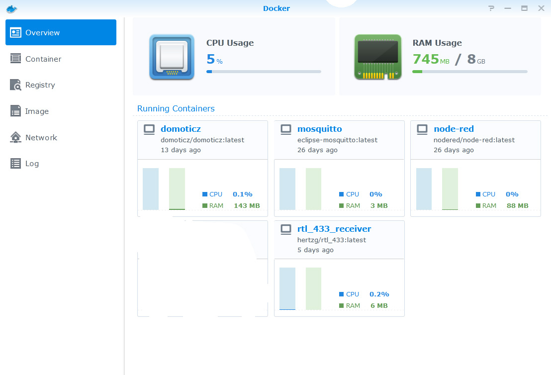

I decided to go an other way, the "Docker containerway"
This works on my Synology NAS, and seems to be very stable, but it is a substantial amount of work to get it all functioning.
I get the data from my 3 sensors from the RTL-SDR receiver in MQTT format from the RTL_433_receiver Dockercontainer. Then you need the Mosquitto broker container to transmit the MQTT messages around your network. You also have to change the initial MQTT messages to something that the Domoticz MQTT Client Gateway understands. I changed the MQTT messages with NodeRed(You need to make flows in NodeRED). These altered MQTT messages I then direct by "IDX"(in the MQTT message) to the proper virtual sensor destination in Domoticz. I have Domoticz also running in a Docker container.
I did tried a virtual Linux machine on my Synology to get everything running, but I quickly abandon this idea. I soon discovered that this solution takes way to much system resources. Docker on the other hand runs extremely light, uses next to no resources.
I got the 3 sensors I wanted to use now running nicely in Domoticz (Acurite lightningsensor, Misol soil moisture, Misol air quality PM2.5)
Synology Docker RTL-SDR to Domoticz
